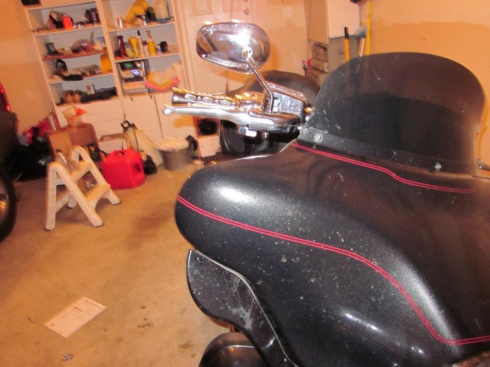

Here are some pics. I'm gonna do some looking. I think I have some that show better what I did with the clutch cable.

OK, these show my re-route of clutch cable. Visor bag covers everything as you can see in pics above. After drilling I used a file and angle filed to lessen arch of cable. Bought a rubber grommet at Home Depot to finish it off. A lot like the Harley one in the lower original hole but rubber isn't as bulky looking. When I paint inner fairing I'll have that original whole covered up.
Yes, I know I wasted a bunch of money buying cromite braided cable that nobody will ever see. Oh, well, by the time I paid shipping cost savings woulda been minimal and I'd have had to wait. Happy I figured out how to hide it.
