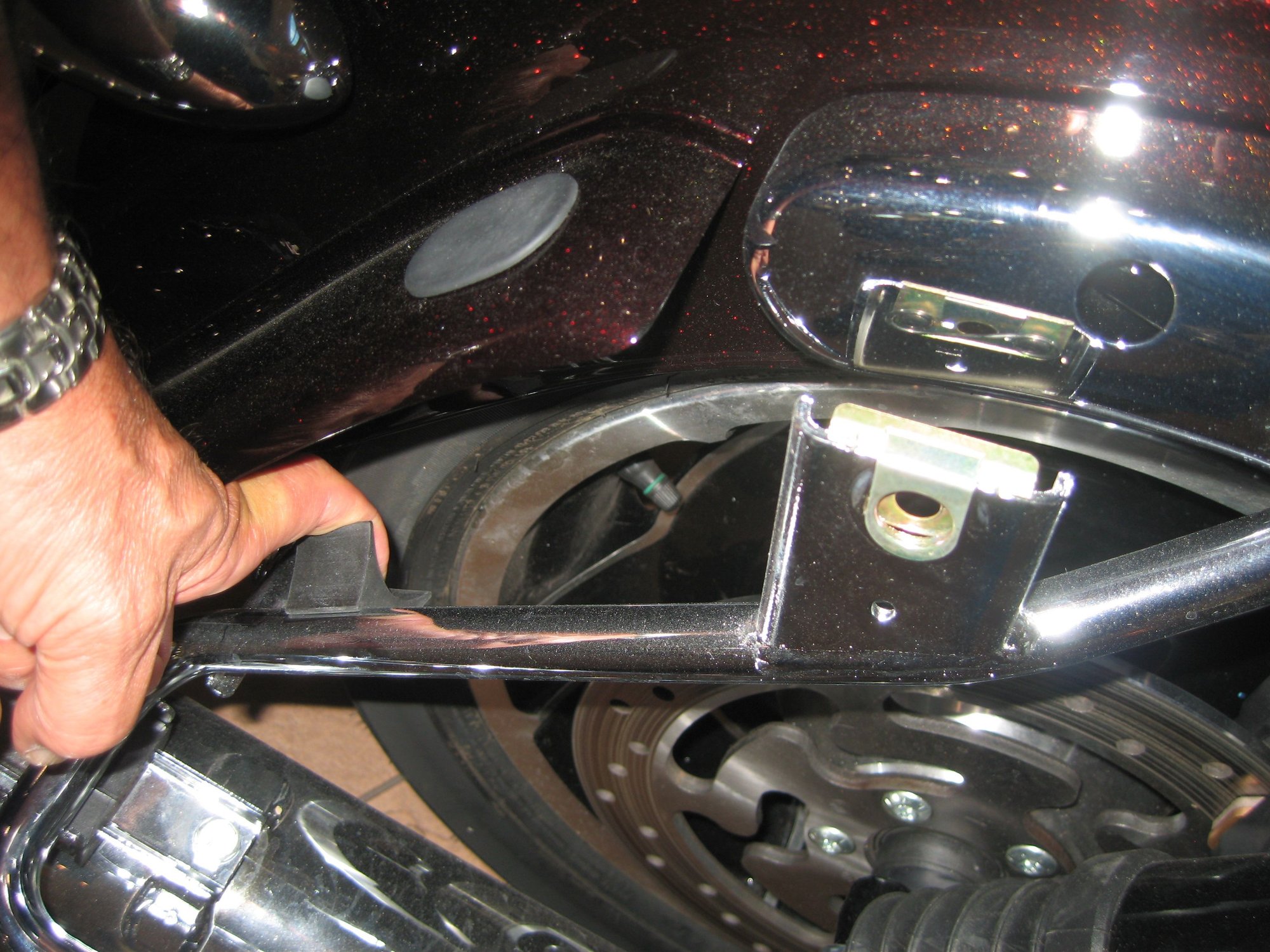

If anyone has the Ohlins #6 with the remote reservoir mounted under a tour-pak, can you please post a few pictures of the installation? I'm curious to see how the reservoir is mounted and if any modifications or drilling of the tour-pak is necessary. I'm also curious how the reservoir mounted on the left side would effect the passenger headset cable/spring assembly.
I have to be honest I think someone in the R&D department at Ohlins did not put a whole lot of thought into the mounting of the resivoirs on a Ultra or Street Glide. I tried to use the L brackets that they supplied with the shocks and really could not find a use for them. Seems as though they also supplied to short of worm clamps too as I scratched my resivor trying to get the clamp to stretch over the resivor to hold it in place while using their rubber mounts. NOT COOL!!
The rubber mounts also seem to be the wrong size when mounting it under the tour pack however they do fit on the saddlebag bar nicely . The only way that I could get them to fit for now without any futher modifaction is by using the supplied rubber mounts and mounting the resivor on the saddlebag support bar between the bag and fender. I used long tie straps to sucure the resivor as I show in the picture. The tie straps that were supplied were to short. The kit also shorts you 4-5x16mm mounting bolts, washers and lock nuts to even bigin to mount the mounting bracket. The supplied L-Brackets also look like that they will rust in time. I personaly feel that a better mounting system should be supplied or one avaiable for purchase. Chrome would also be nice. I have supplied a pic to show how I have mounted the resivor until I can figure out a better way it's going take some thought for sure. I will probably wait until winter to do a better job.
Good Luck

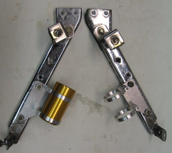

Those brackets were originally to fit onto the chrome fender support found only on the 1986~2007 FL's. The plastic mounts and 8 bolts w/stop nuts are to be used with the stainless steel mounting brackets and the mounting holes correspond with the welded on nuts on the backside of the chrome fender support.
The bottom photo was the first day I started developing the ressy mounting system on a shock that did not exist. No Ohlins R&D department, me. There was no 2009 FL's than as they did not exist.
The top picture is the billet ressy clamps & mounting plates I make so you do not need to use hose clamps. They are not meant for the 2009~2013 but will work on a 2014 as well as Dynas & FXR's.

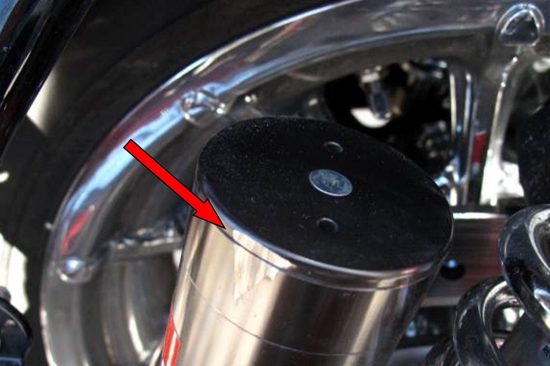

The correct way to install the SS hose clamp over a ressy is to use the appropriate nut driver than install one rubber block & hose clamp at a time. Never stretch the clamp over the ressy except to get the threads started. I sent you pictorial instructions showing you where I mount the ressys on your 2009~2013 and it was never ever meant to be installed where you mounted it. I drew into the HD-909 instructions (the ones you received a photo copy [in the post two/2 above this one] & the ones I e-Mailed you [original] with your tracking # and paid receipt when I shipped the shocks to you). The directions were specific on informing you what model years and where the stainless steel brackets are to be used. When in doubt, call me! I have been up since 5am today and it is 6:16am now, plenty of time in the day and it is always a pleasure to speak to you and beak up my crappy day.

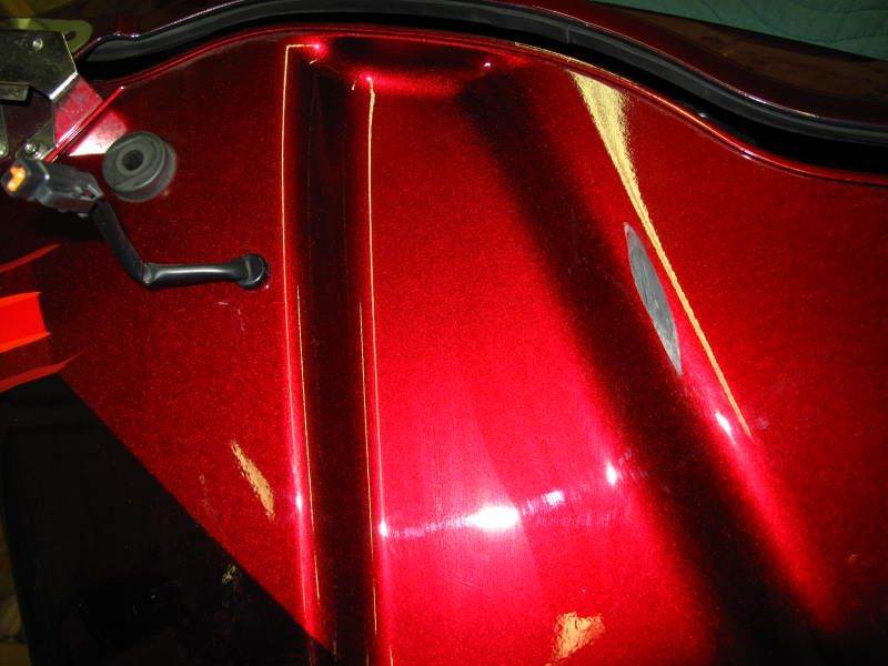

The hose mounted ressys fit like a glove under the tour pack of your bike. Just call me on that as they are very accessible that way if you leave the tour pack on. Her is the very first one we did when I lent HDF premiere member masterblaster the prototype for one of his long distance trips during development.
The picture below was on the very first 2009 FL's that came into the local dealership so I could design the second mounting system for the brand new Harley model. This is the location that I chose to mount the ressy on your exact model. The mounting that you have as the "only way it would work" is contained in the pictorial instructions that I sent you prior to you receiving your shocks. It is in the exact same place as you have it on your bike, the way I designed it the first day the 2009's were released to the general public. It is your bike and you can mount it anyplace you wanted to mount it, I love innovation. There is many different ways to mount the ressy which I will not go into.
The mounting system needed for your bike is only the hose clamps and rubber blocks. Nothing to chrome. If you wish to purchase a clamping system from me as shown above, it is available in silver powdercoating or can be chromed. The chromers want over $100 just to chrome it adding that price to cost of the total shock package. All you have to do is call me and I have over 100 sets in stock.
