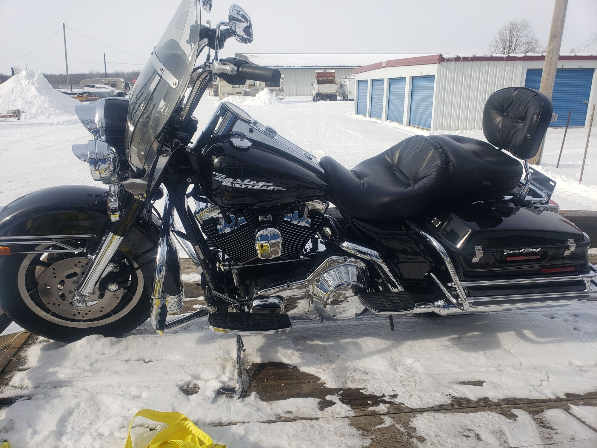

Hello to all
Any ideas on a 99 Road King efi police bike has a USB 3 programer 16k miles
It was running fine started to backfire out the exhaust on decel then it started having a problem starting like had to hit it 3-4 times before it would start then it started ran for about 2 min then stalled and hasn't started back up since replaced the battery just because it was a couple yrs old not getting any codes seems to have fuel spark is their but seems to be weak to me anyway haven't put an ohms on it yet. Any ideas would be greatly appreciated was told the stator would do that but its never had any problems at all with charging.
