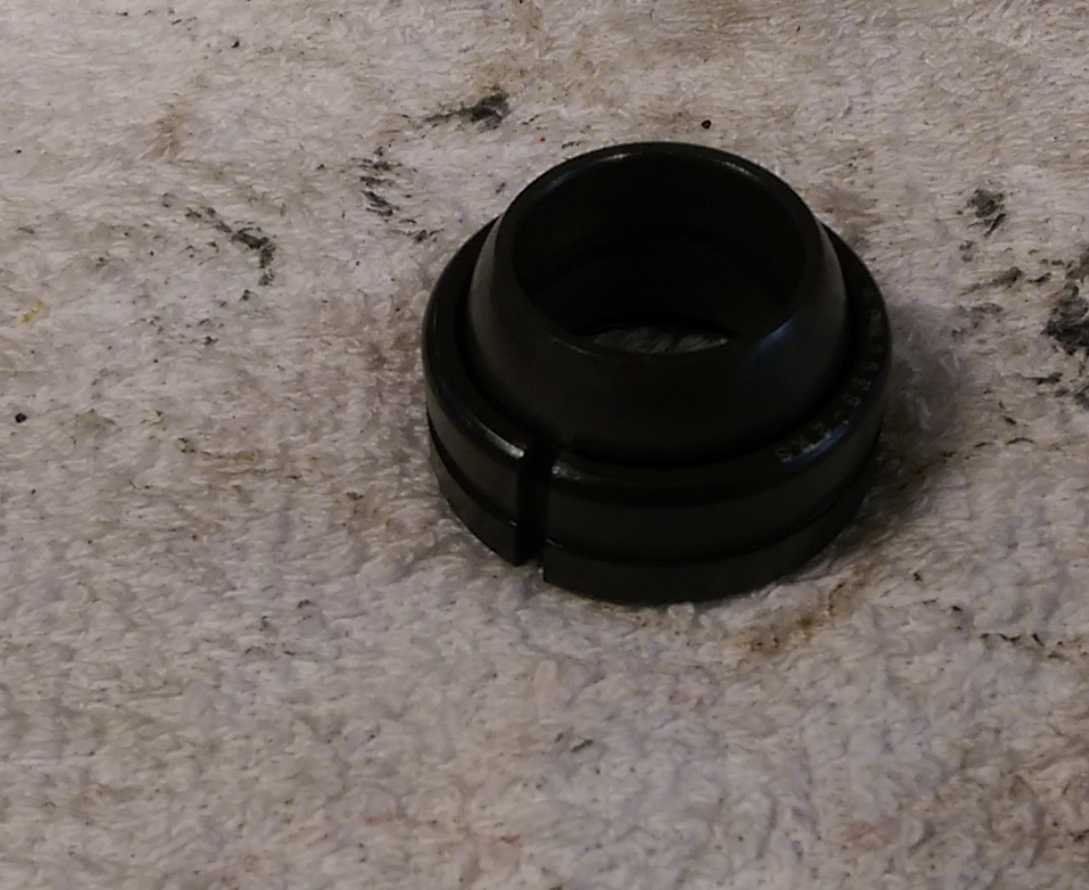

grbrown and max thanks for the help. who makes the heavy duty sperical? i would prefer a straight bushing. that rolly polly pos i do not like. (yes i said helical, my bad, i meant the spherical)
i just ordered a set of Sta bo bushings. probably just get it all apart, change out the bearings unless i find something better, then get it aligned.
to clarify some other stuff, i found the front wheel had lost its balance weights. i have the stock mag wheels, and both were balanced by a reputable shop. i think they may not have cleaned the rim prior to applying the weights as i found a small amount of the double sided tape was present.
also noticed the weights on the rear wheel are right at the valve, that makes no sense. i dont see the heavy spot dots, probably came off in a cleaning.
just got the front wheel bearings today so this weekend will put all new bearings in and balance both wheels.
Here is one.
https://www.vxb.com/GE25ES-2RS-Doubl...n-p/kit646.htm.
I'm not sure if they are any better. They were recommended here but I can't find the original post. I have a pair that I plan to try.

Here is one.
FWIW, I would not run the bearing I listed. They cannot handle enough side load to drive out the center piece without breaking. When it comes to removal, it might be a bitch to get them out of the swingarm. The side seals take away from the axial thrust..
