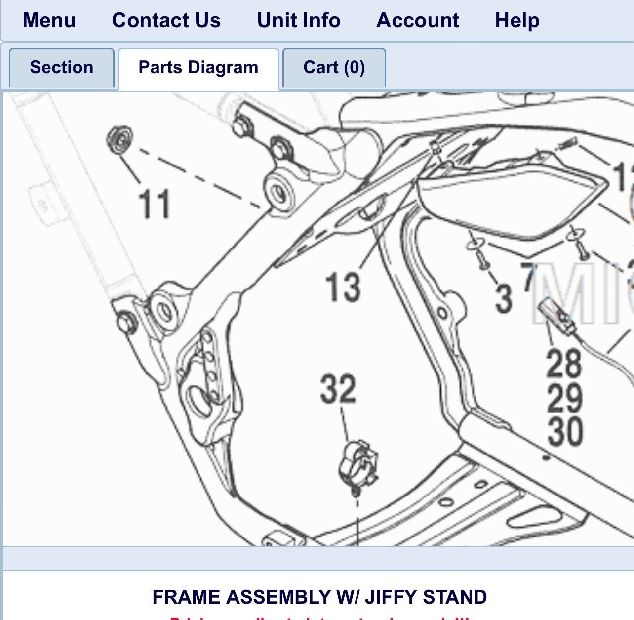

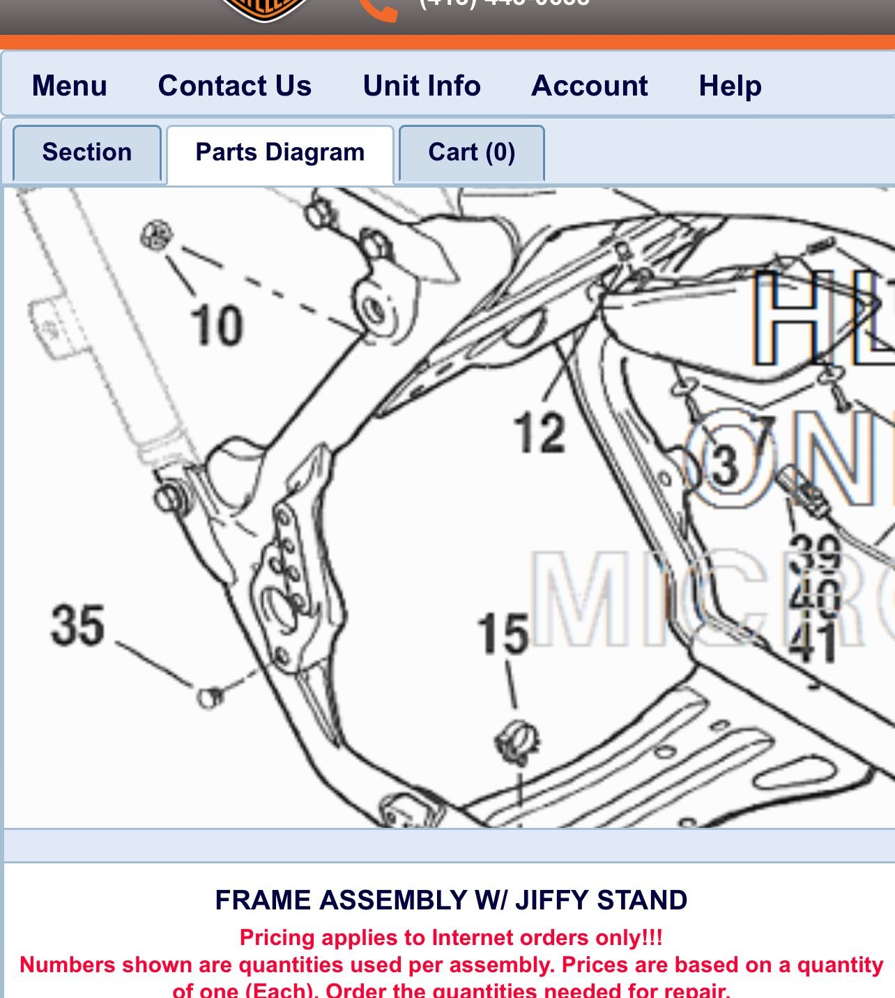

here is a 2011 frame diagram. Yes the swing arm mounting bracket is part of the frame but number 35 is a plug covering threaded holes. Maybe this is where the cce bracket attaches? 🤷🏾
here’s a 2015, no holes.
but as the other poster said, how would it clear the pretruding passenger mounting holes?
