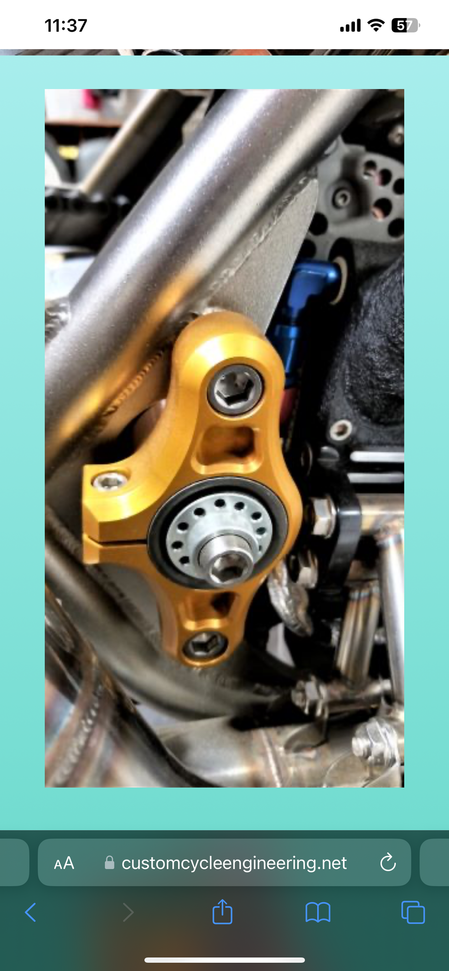

my question is has any tried the CCE mad dog mounting system for the swing arm? I’m searched this forum and others and can’t find any experiences.
thanks.
https://customcycleengineering.net/m...-mounting-kit/
