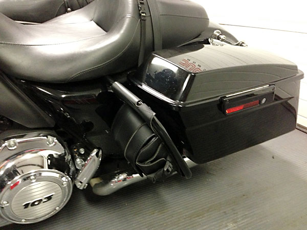

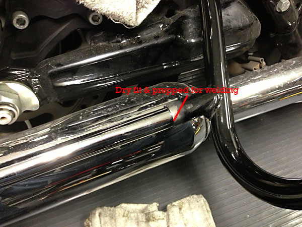

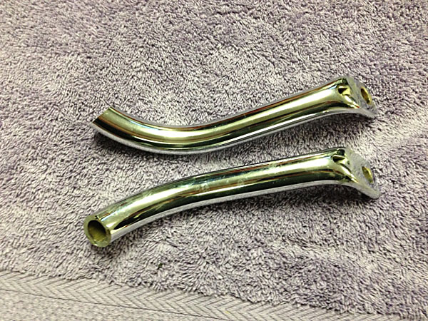

well, I finally made a little time this evening to do this. Happy to say that it seems to have worked out well so far. I cut the stock bars, dry fit everything and then welded the new black crash bars to the stock under-bars, cleaned up & painted the welds and it's done. Saved a few hundred.
The cut off pieces:
The final product:
Cutting & Welding video (courtesy of my daughter with my iPhone)

Sweet! How much overlap was there where you slide the crash bar over the stock bars you cut? Looks like another snowy day project!

I'd guess maybe a half inch. Would have liked more, but I felt comfortable with it. Haven't ridden with it yet, but I feel good about it.

I guess as long as the weld took to it good it should be plenty strong enough. I think I might try making some sort of sleeve for mine though to get a little more overlap.
