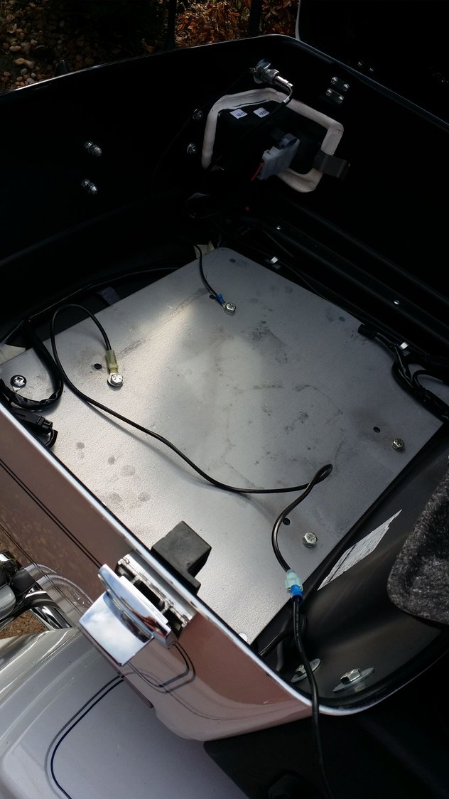

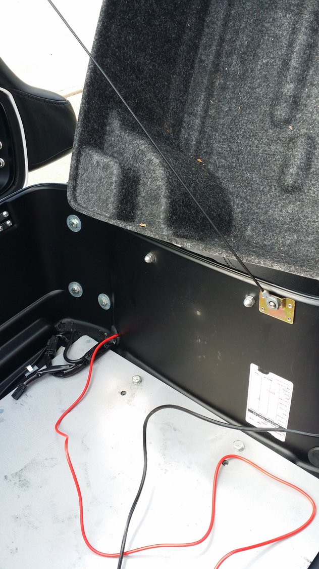

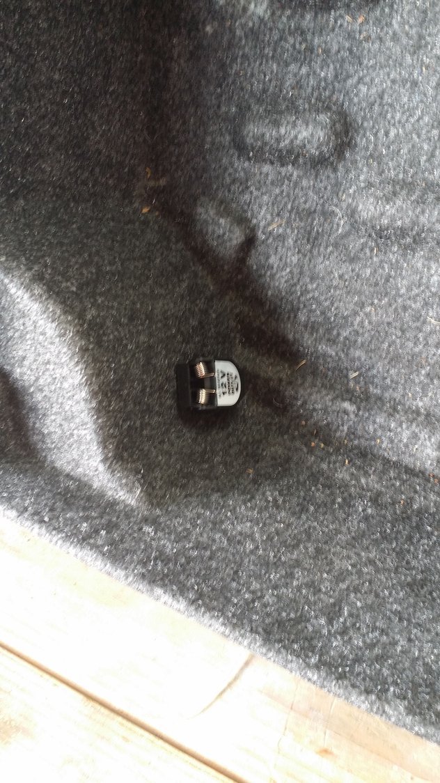

After doing much research on this forum (thanks for all those that have gone before...), I decided to add the 12v outlet to the tour pak. I went down to the local O'Reilly Automotive to purchase the supplies. I was surprised by their selection actually. I just went with the standard lighter type outlet, this way, I can plug in a DC/AC converter if I absolutely had to.
I removed the liner and traced a 1.125" hole about 2.5" above the floor of the liner in the right rear corner. I used my trusty "MacGyver" knife to cut out the hole. I then installed the plug and oriented it correctly. The plug is all-weather and has a nice spring loaded cover.
The red wire had plenty of length (12 ft.) but the black ground wire was only 1 ft. long. To give myself more maneuverability while re-installing the liner, I added an extra length of ground wire. I then secured the ground wire to the base plate of the Tour Pak.
The red wire I took out of the Tour Pak through the existing hole in the front left corner and out toward the battery. I installed an inline fuse along the way.
Then I just ever so gently placed the liner into the tour pak being careful not to dislodge the light housing or the outlet on my way in. I did have to use a little elbow grease to gently contort the liner to get it back in. Wasn't too difficult though. And viola! power in the tour pak.
We are getting ready to take a long trip and I wanted to be able to plug my phone in so I could use the GPS with my Sena 20s headset. This way I won't have to worry about the battery dying or accidentally leaving the phone in a mount on the handlebar or facing the possibility of it getting wet in a rain storm.
It may not be for everyone, but it will work for me. I thought since I have learned so much from the folks here, I would share this little project.
