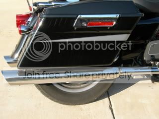

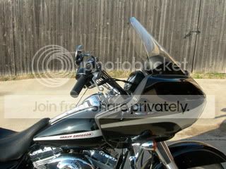

I have finished the upgrades (for now).
I added Wide Glide handle bars. Tried them inline with the forks but ended up rotating them to get a more confortable zone. No more tingling hands after riding for a while.
I also put on D&D Police Interceptor mufflers.
And added a Stebel Nautilis Air Horn (Dual tone, 139db) sort of high pitched but loud. I mounted it on the stock horn mount by using a couple of larger metal washers on either side of the mount. The power is directly from the battery to the relay. The clear tubing is the air intake and I ran it under the seat to keep it somewhat clean.
That's all for now. Keeping it mostly stock at this point.

How was the bar swap? I have been thinking about the wide glide bars for mine. do you need to extent any of the cables?
Old Feb 11, 2007 | 07:30 AM
edilgdaor's Avatar
edilgdaor
Posts: 13,820
Likes: 6,615
From: Northern California
Default RE: Updates to bike
^^^^^yeah, tell us about the bars. What year bike were the Wide Glide bars from ?
My issue is not so much the reach, but the angle. Let me see if'n I kin 'splain this rite.... my hands feel like the ends of the bars need to angle back towards me. It's like the bars are too close to being straight across.
I'd rather the angle was more like ( ignore the dots at the left because otherwise the spaces get lost ):
. ________
instead of :
. ________
. - - , when looking from the top.
Nice taste in bikes, by the way.....

The bar swap was not bad. No cable extensions were needed, I just clipped some of the tie wraps on both sides. I did reroute the clutch cable outside of the black plastic where it normally runs and made sure everything worked OK before I tightened it down. The Harley part number is 56097-93. I did pick up another stock left hand grip so it would be easier. Be careful when you take off the right hand assembly. I followed the directions and put the head of a tie wrap (between the black housing and lever) to keep the lever away from the switch but it wasn't large enough or I wasn't careful enough and broke the switch plunger and had to replace the switch.
It helps to have the shop manual when you are doing anything.
It really wasn't that hard to do as I am not much of a mechanic. It helps to use the allen wrenches with the ball end on the handle bar clamps, especially the lower bolts.
Jim
