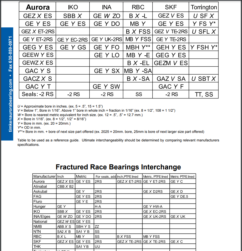

This will be the thread that never dies… Where did you guys source these bearings from? I’ve searched and haven’t found any online. 123Bearing has the part # but shows a spherical heim style bearing, and I thought the original post was about getting away from the spherical design and back to a solid bearing to reduce flex.
It was a long thread to go through, did I misunderstand?

Question
Disregard, I read through it all again and now understand the spherical bearing was used due to the sloppy machining of the swingarm by harley. The heim style sphere allows the bearing to align over a common shaft. Now if I could find the damned things to buy for my swingarm that's sitting on the garage floor... This conversion chart will help anyone looking at swingarm bearings.
