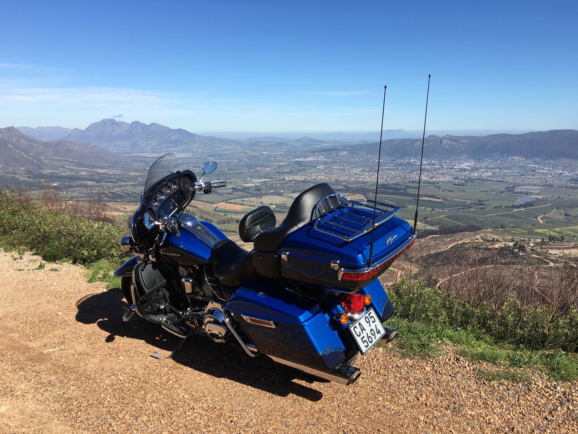

Good luck with the Sale........and new toy when you get it......
My CVO still going strong.......heres a recent pic of a ride I did
Old Aug 16, 2017 | 03:02 PM
  #169
Boltsfaninmo's Avatar
Boltsfaninmo
Joined: Jul 2009
Posts: 590
From: O'Fallon, MO
Beautiful Bike! Why in the world would I sell something so awesome?
