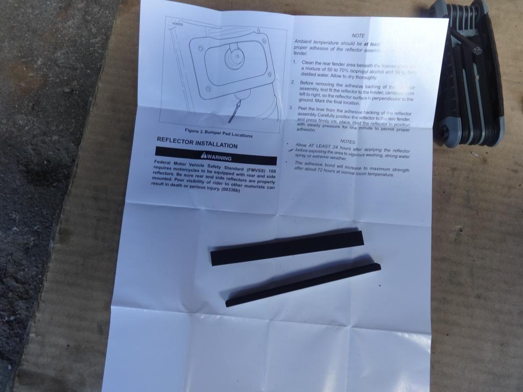

I tried a search but could not find the answer to my question. I just installed a curved plate on my 2013 Road Glide. Where do you need to install the longer thin bumpers? I attached a couple of pics. Harleys instruction sheet is pretty
lame.

But I believe the rubber bumpers is to install behind the plate anywhere it may make contact with your fender. I just ditched them on my last bike because the plate had plenty of clearance and never touched.

If you can jack the bike up with a bike lift it makes the job easier. The foam should attach to the rear of the plate frame down low and make contact with the rear fender out of site. Use blue loctite on all mounting bolts/screws.

They go on the inside top and bottom of the rear section of the plate bracket to keep the plate itself from rattling and/or making a buzzing noise.

Installed this item a few months back on my 13' RGC. I was unable to use the foam strips as they prevented the four frame screws from being threaded properly. They caused the frame to stick out a bit too much for the small screws to seat properly. Ended up not needing them as the plate and frame don't rattle or rub so I never used them.

Ratchet box wrenches do wonders for those tight areas. I don't like using the foam without putting tape or something over the paint. The foam holds dirt and then acts like sandpaper.
If the plate rattles, cut the foam down to reduce the thickness.

I have the Kury plate which is the same. Even bolted up tight, the bikes vibration causes the plate frame to vibrate and without the foam cushion between the frame and the fender, the mounting bolts will fail at some point. Your bike, your call on the foam.

The thin ones go between the plate and the backing plate to avoid rattles, Mine did not need them
