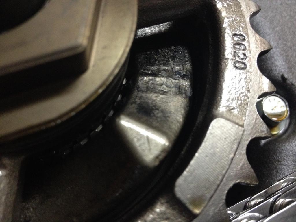

When you find the magic recipe for comps let us know, I'm on my 4th one in 50,000 miles and have tried many fluids. Right now I'm on my second 2014 style and running harley non-syn and I used an extra spring from one of the ruined comps to try and get this one to last more than 6 months.
Heres my last one. Sadly it looks like your's is already starting to wear in the same spot?

Personally I think the wear is accelerated by low rpm riding and pulling taller gears.
I beat my '10 for 30k plus miles, and the comp was in great shape when I sold it. My other two buddies have had similar experiences. We all ride pretty hard in the higher rpm ranges. I never cruise below 2500.
Our other buddy has had a couple comps in his '13 in 12k miles. He rides it like it's a diesel, short shifting and using low rpms. He likes to feel the torque, as opposed to higher rpm power.
YMMV, this is my opinion only judging by how my friends and I ride.

They are only about $ 120.00 and is basically a tray that catches oil and directs if to the shaft and spokes. Their website is old and quirky. They know and are in the process of remaking it.
Also they have a PEEK thrust washer in testing to replace the needle bearings in the 14a model comps.Look em up on Facebook. Here's a pic of the compensaver with the Hayden Tensioner I installed recently. Will be opening it up again in another month or so to have a look at wear.
p.s.
If this one craps out I'll put in one of the BDL comp sprockets, There's a few members on hdf using them. So far so good.
