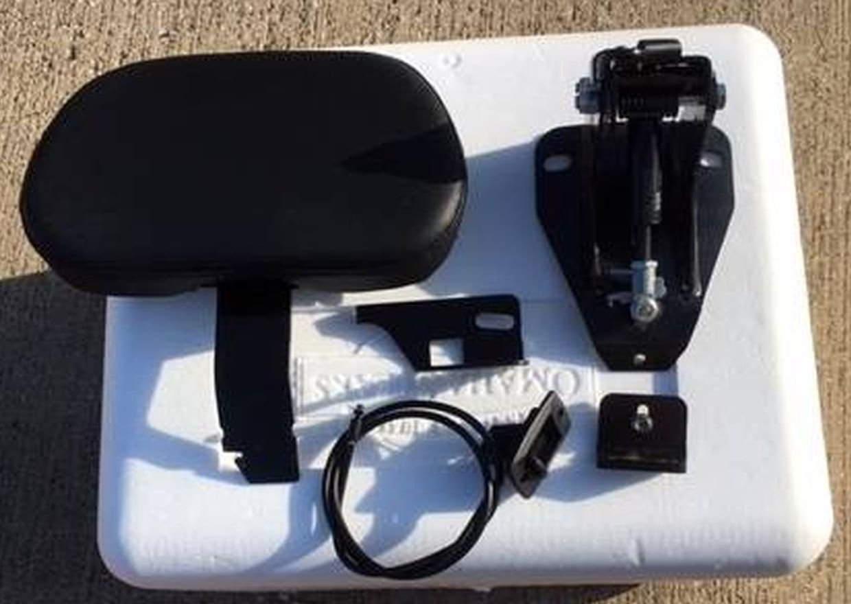

I recently started riding a 20115 Harley-Davidson Freewheeler. I upgraded to a Sundowner seat (52000183) and installed a quick detach passenger backrest. After two or three hours my back begins to hurt so now I want to install an adjustable rider's backrest. Harley-Davidson has the receiver (54099-10) but not the backrest. I have located the 54099-10 receiver and a 52501-09A backrest (shown below) that was removed from a 2016 Triglide. What is the difference between a Triglide frame and a Freewheeler frame? Apparently not much because they both use the 54099-10 receiver. I found a video in which the man was told that his adjustable backrest would not fit his trike but out of desperation he went ahead and tried to mount it. It bolted on his trike like it did on the motorcycle that it was removed from. His backrest looked identical to the backrest that Harley-Davidson says that it will not fit a Freewheeler. My situation is different because I have to buy it to try it. I would like to hear from those of you that have had hands on experience with the Freewheeler backrest or can tell me why a Triglide backrest will not fit my Freewheeler

The only problem I have ever found is trying to put the adjustable mount under a Hammock seat. The mount is 1" too tall. You can cut it down, but stock it isn't correct.
On all other seats by Harley it seems to do just fine.

I have a backrest kit and backrest for sale that I took off a ‘17 TriGlide The part number says it with fit a Freewheeler with the Sundowner seat.
I had an adjustable backrest on my Freewheeler that worked fine with the Sundowner seat

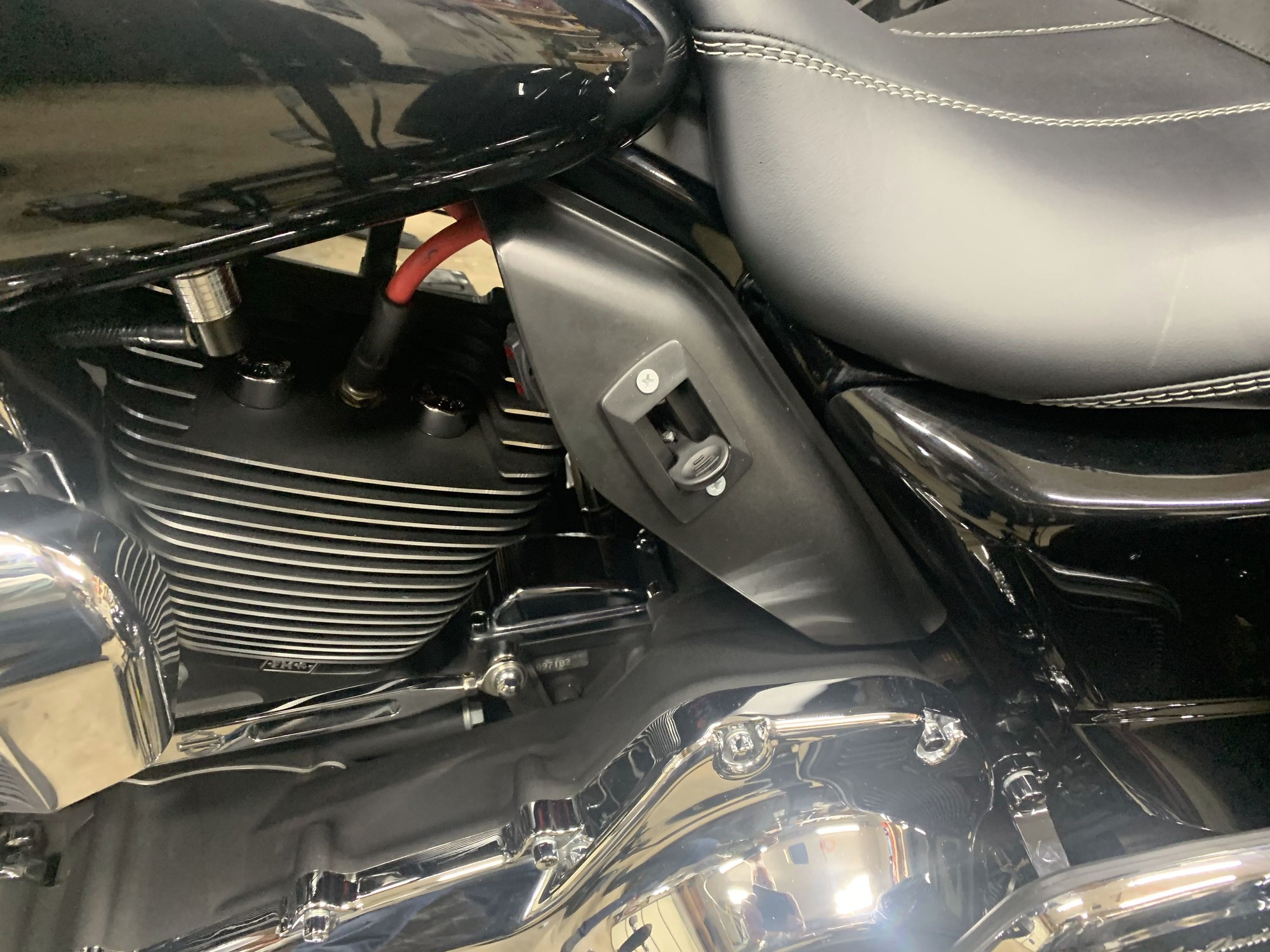

Same one that is on my wife's Freewheeler as shown by OldRon. as for mounting the control, if you have midframe heat shields, its real easy to cut and mount it in the left side heat shield and super easy to then adjust as well
Factory seat recovered and heated hence the diff look
Super easy to mount here!
