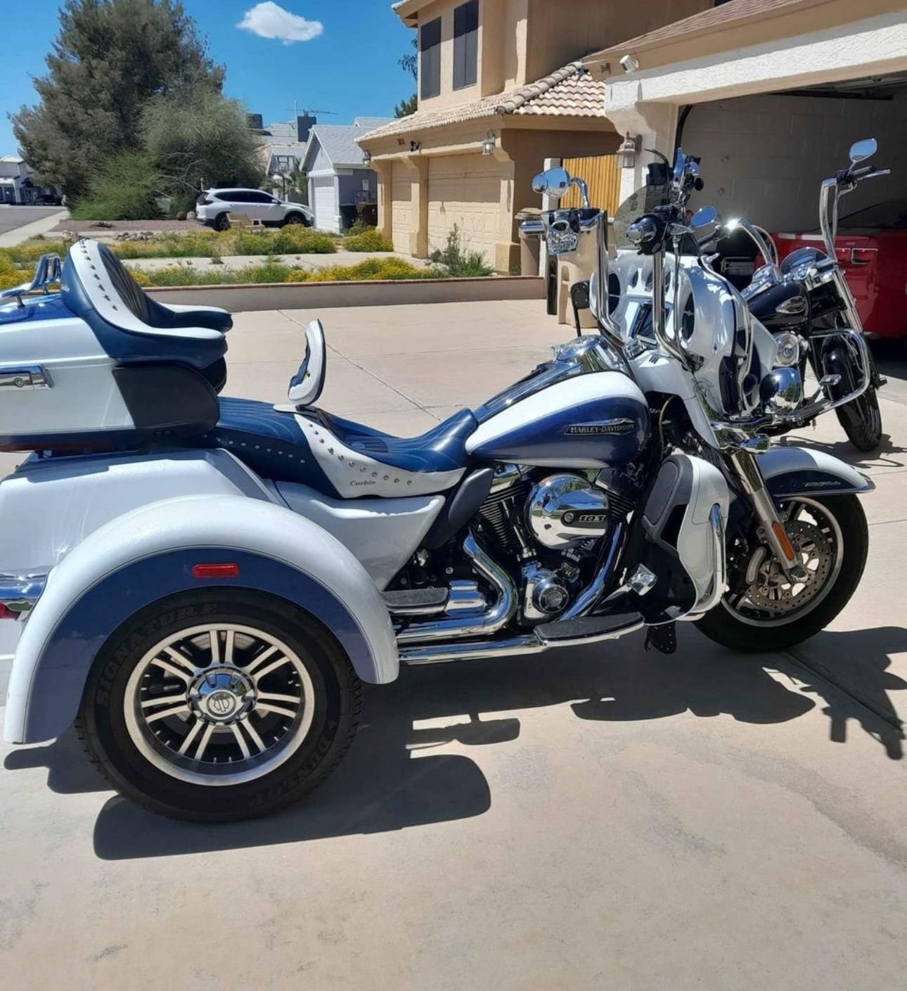

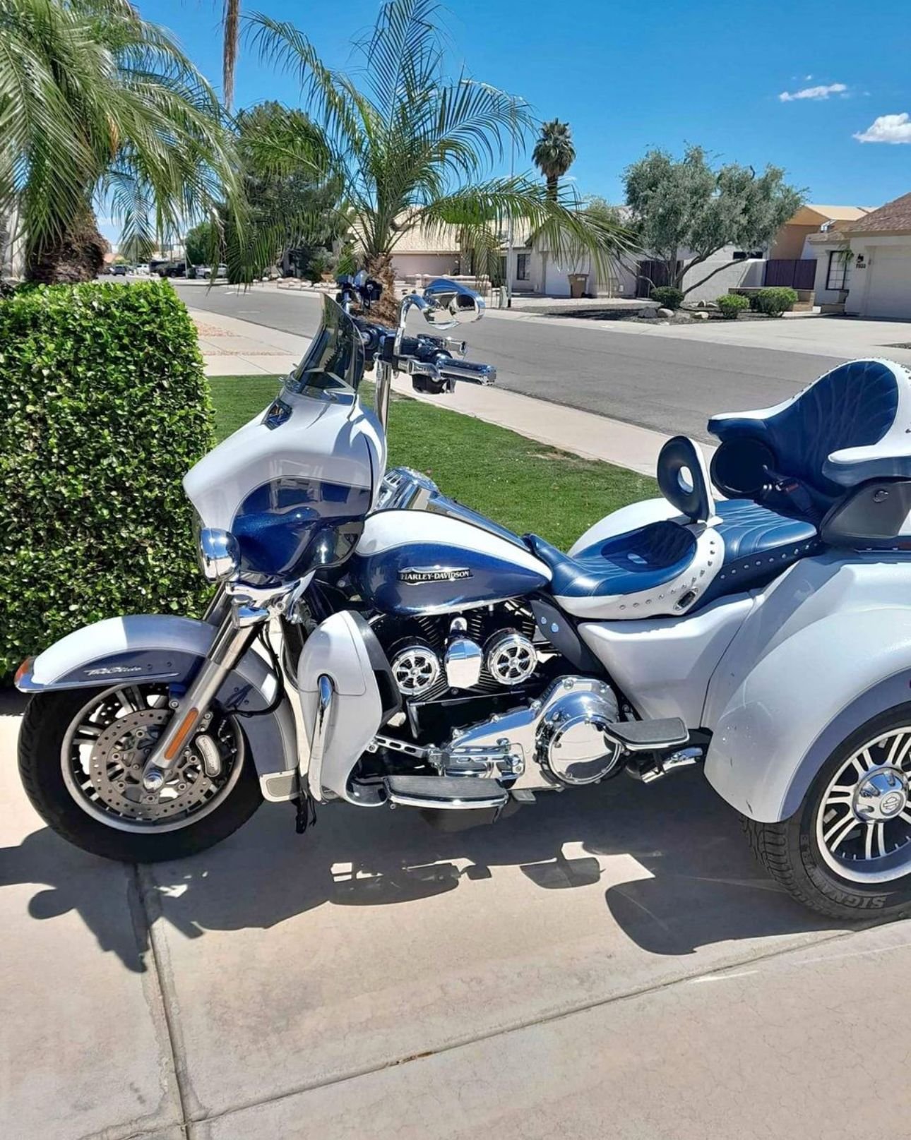

I put on LA Choppers 12" tall Grande Twin peaks.
Made in the USA and they're a nice 1.5" diameter bars. (They're not "meat hook" type, but rather a 90* miter cut look)
Still retains stock cables.
Link:
https://lachoppers.com/products/gran...-1-5-fl-chrome

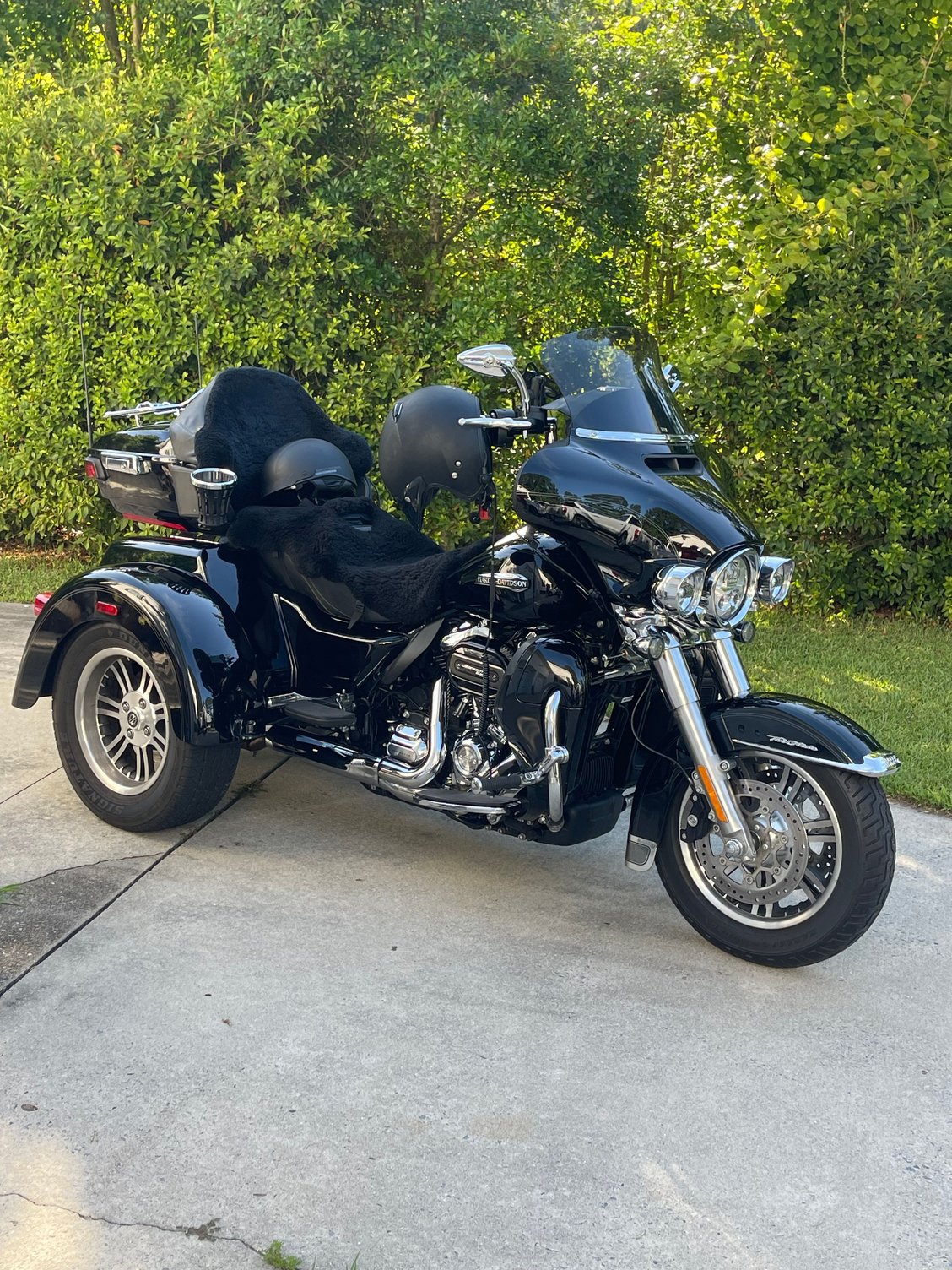

These are 16" in reality they are more like 14" when you measure them, but they are perfect and the handling is first class

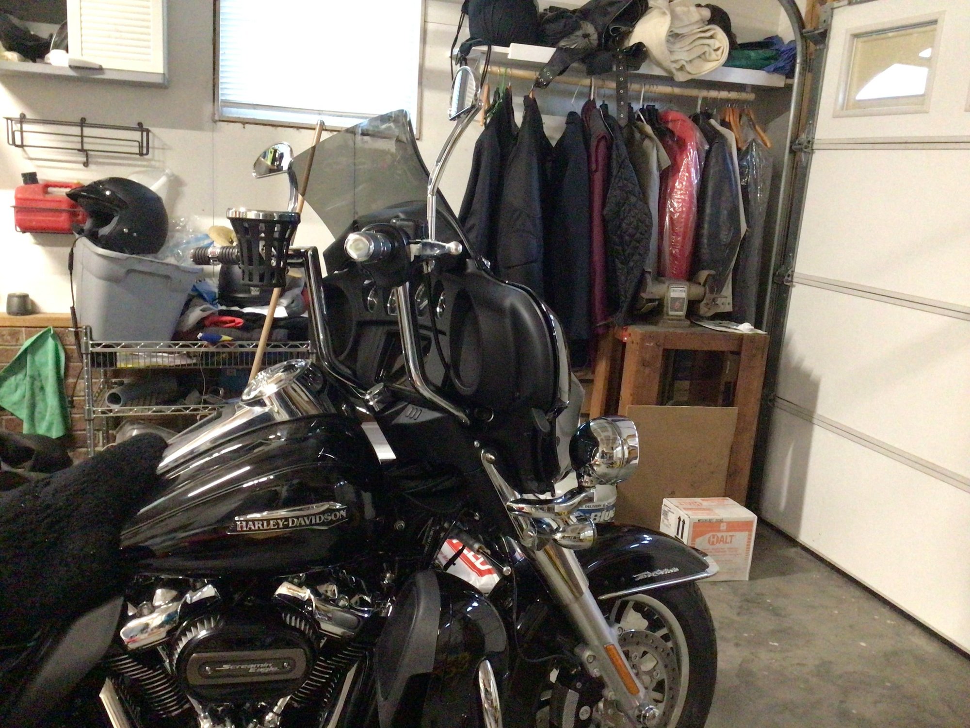

I put HD Tallboy bars on my 2016, my buddy did the mini apes. He's 6'4" and I am 6'6". We loved the grip angle of the Tallboys, but neither was the right height for us. When getting new Trikes a few years ago we both went with 14" Chubby's and love them. If I could have tried some 16's I might have gone with them, but the 14's are a huge improvement.
I now have thousands of miles with my 14" bars and love them. It all depends on your size.
As far as cables, Fat Baggers is where I found what I needed.
