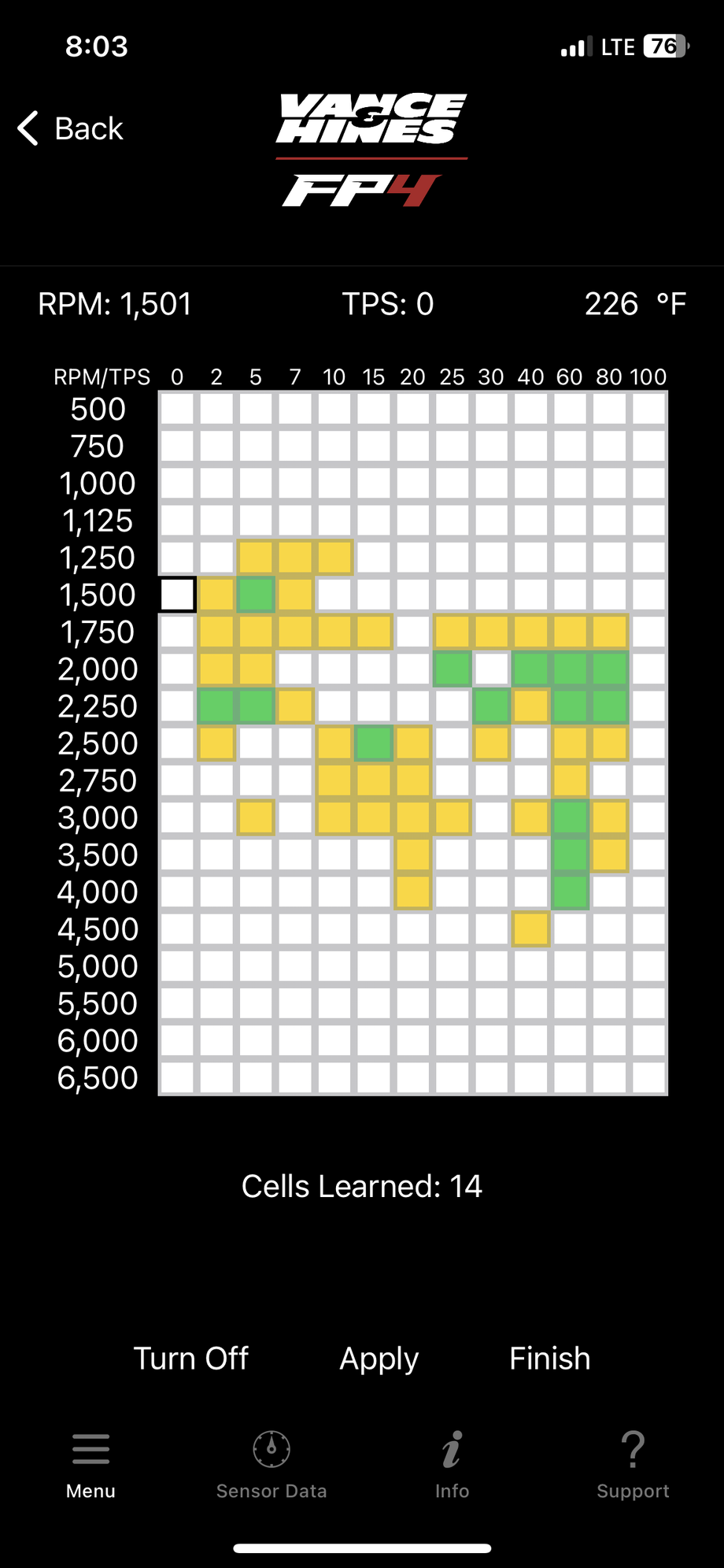

Default Reviving this thread. Partial learned cells
Originally Posted by SNDSLGR
After using a FP3 on my '15 ultra limited I talked a friend into buying one for his '08 Street Glide.
He has been trying for 10 months on and off to get a good autotune. The canned map gave some nice improvement but like the rest of us he wants to use all the features the FP3 offers.
He can initialize the autotune and it populates cells but will not EVER turn a cell green, not one. I can get 5-10 green cells in 10 min on mine. ( I get they are different bikes and mine is more modern but come on) ZERO green cells in what must be hundreds of miles by now.
After talking with VH many times he has changed his plugs, tried altering the O2 sensor voltage, and now has installed new O2 sensors. Nothing!
Anyone else have this trouble? VH seems to keep putting him off without much action, its your android (tried other phones including Iphone) ...working on it... must be the bike...adjust the O2 values etc.
At this point I think its time for them to step up and ship him a new unit to try out if they cant answer what is causing this malfunction.
No trouble codes, bike runs very well, 08 Street glide, K&N filter, otherwise all stock.
I have a 2011 Dyna Fat Bob FXDF. I purchased the Vance & Hines FP4 to accompany my Freedom Performance slip-ons, & Vance & Hines VO2 air intake. The product has worked decently on my bike. I can maneuver through the app just fine with the occasional Bluetooth disconnecting. The only issue I’m experiencing is with Auto Tune. I started using the “Quick Setup” and only got Orange Cells. After reading this forum
on the FP3/FP4 some users experienced success when using “Advanced Setup” and selecting AFR to 14.7 (default) & O2 Sensors to .8v. I followed these instructions and on my next run I was able to see more green. Now, my concern is, after doing two runs (both 60+ minutes each) the chart is not filling up as other users. If somebody has an answer for me that would be great. I’ll be attaching the original chart with “Quick Setup” and the most recent 2 using “Advanced Setup”. I’ll also show my bikes O2 & Targeted AFR info

For a cell to be learnt requires for an unspecified period of time the engine rpm and throttle position to not change.
The last picture shows you are using a very small part of the available revs and throttle position.
I can only suggest you find a very long uphill stretch of road and try and hold various throttle positions. The uphill will allow for keeping the revs down whilst needing higher throttle openings that will allow for a good number of cells to be hit.
Thank you for the response. I will try and give this a try. I just found it odd. That last run specifically I did 90 minutes of riding. I did Highway at about 45-55mph, city at about 25-35 mph, mountain up hill at about 45-55 mph, and interstate at about 60-80mph. It never seems to populate many cells down low now matter how long I hold it in that range for. The only time I see the most cells populate is when I start opening the throttle

Holding a steady speed will see a steady rpm and therefore a very narrow part of the table populated. You need to vary things from tick-over to WOT as you feel comfortable.
Based on what you have done if you continued until you get rid of the bike will yield the same result you are seeing. The instructions may be a bit vague as to how you need to hit more cells.
On the flat will see the engine unloaded and so as the revs climb quickly will see you change gear early hence steep hills help.
In summary you need variety at all speeds.

i understand. I’ve been trying to get different kinds of riding done to try and populate different results. I got this run today to and from work. About 30-40 minutes total. Trying using the cruise control this time and rode a bit in town at lower speeds. Seeing some more results in the bottom and mid range. Still not quite as I’ve seen from others but it’s something. I won’t apply or flash this one yet. I’ll probably hold on to this session a bit longer than the last two. Maybe I’ll fully flash the auto tune once I’m done with this run. Bike runs fine. The FP4 says there’s no error codes on my ECM (not sure if it’s 100% good or FP4 not reading correctly) I had already added a map closest to my setup (Freedom performance slip ons, Vance and Hines VO2 hi flow intake) and it seems fine. Hopefully the auto tune will dial it in as much as possible
