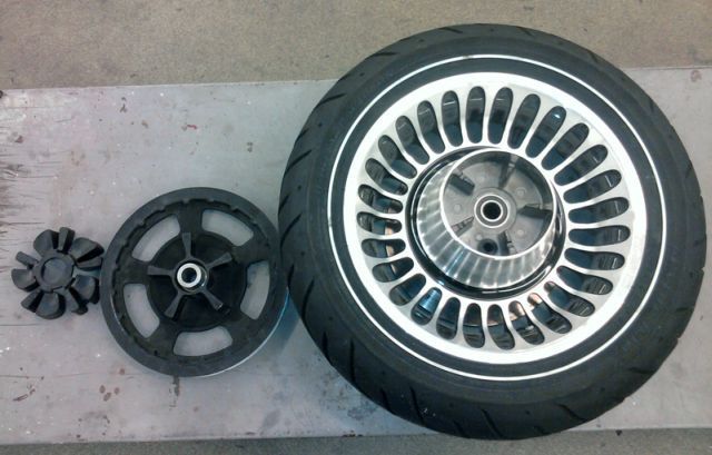

You are a wealth of info. I ended up finding a brand new 16x5 Cush drive for $105 shipped.
So, I jumped on it. It's on the way. Now, I've got to find the touring hub and your info has helped a ton. I think I'll be happier with the 16" as it seems like there are many more tire choices and I can step up my tire size later if I go to a 3/4" belt or maybe a chain drive.
Hopefully, I can sus up a hub pretty cheap and find a good Indy to help me get it all together.
I'm pretty stoked about ditching the solid wheel.
Are there any other special considerations I need to be concerned with on the touring hub/axle setup?
Thanks again!

How will I know if the Cush is removable? They didn't specify the year of the Cush drive wheel. I've asked them for a part number. Or, I could just be patient and wait for it to come in.
It won't be removable...16x5" rear wheels were used 2009-2015 Touring Models with an integral cush drive.
Removable Cush Drive - 2008 Touring (only)
2007 - No Cush
(below)
2008 - Removable Cush
(below. *Note #32 - Spacer used behind the bearing to allow 15mm wide bearings to be used in a 21mm wide bearing hub and keep them out close to same dimension as the wider bearing were)
2009 & Later - Integral Cush
(below)
A 2000-2007 Softail or
2000-2008 Touring hub should have the potential for project execution. , but to be safe, I would check rotor mounting surface to pulley mounting surface to right side bearing (rear "Primary" side) dimensional relationship compared to your deuce. The softail hub should be a "no brainer" because...well, you have a softail, but i can't swear without measuring that touring hub is identical.
