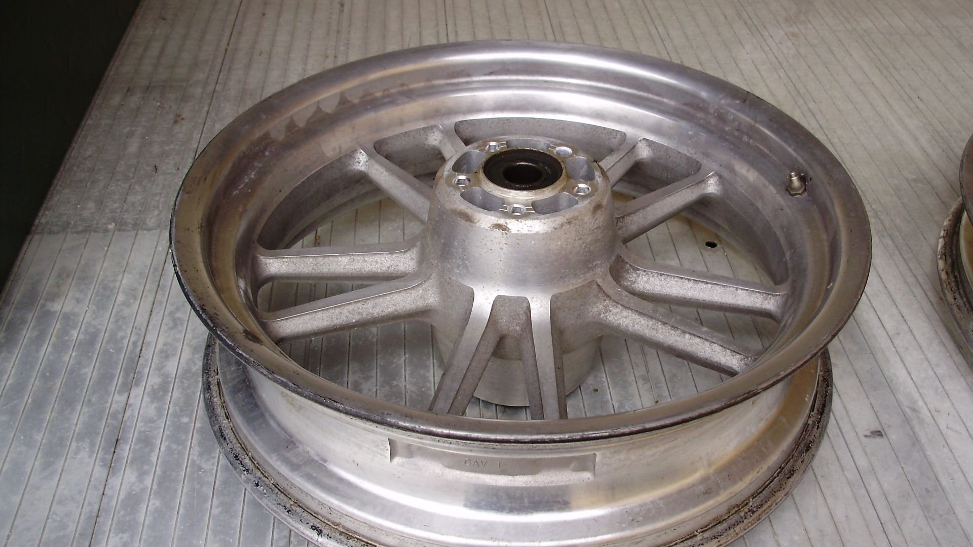

Make sure the Front Rotor is for those "Spoke Mounted" Mags (Switchblades). The Rear is not unique.
I haven't seen a pic from you. I'm assuming the "07 superglide wheels" are "Switchblade" Mags

Old Feb 14, 2017 | 08:26 PM
multihdrdr's Avatar
multihdrdr
Joined: Oct 2011
Posts: 11,175
Likes: 2,483
From: Nor Cal
Yeah, "Switchblades"... always liked them. Too bad (my perspective) they aren't dual disc.
As I hope you can see, the front rotor is somewhat unique. Not interchangeable with your SBob "Hub" Mounted rotor(s)
