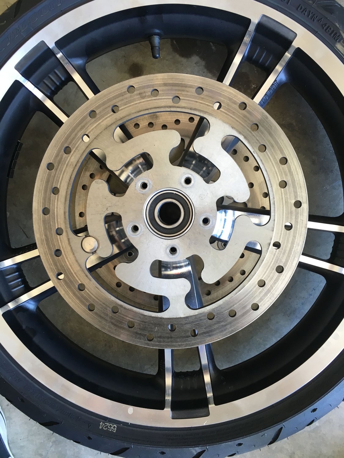

I don't recall seeing one installed on a bike. They use the same inner spacer and bearings as the '08 up bikes however, they used rear rotors on the front of the trikes. I had this picture from a while back that shows how a front '08 rotor sits on the wheel.

Hmm...They show the FreeWheeler OE Front Rotor (not your pictured rotor) has a "Front". It's used as a "Front" on several 2-wheel single disc bikes
I stand corrected, the 41500068 is a front rotor. My hasty search took me to the 41500069, the rear, which I failed to see.
