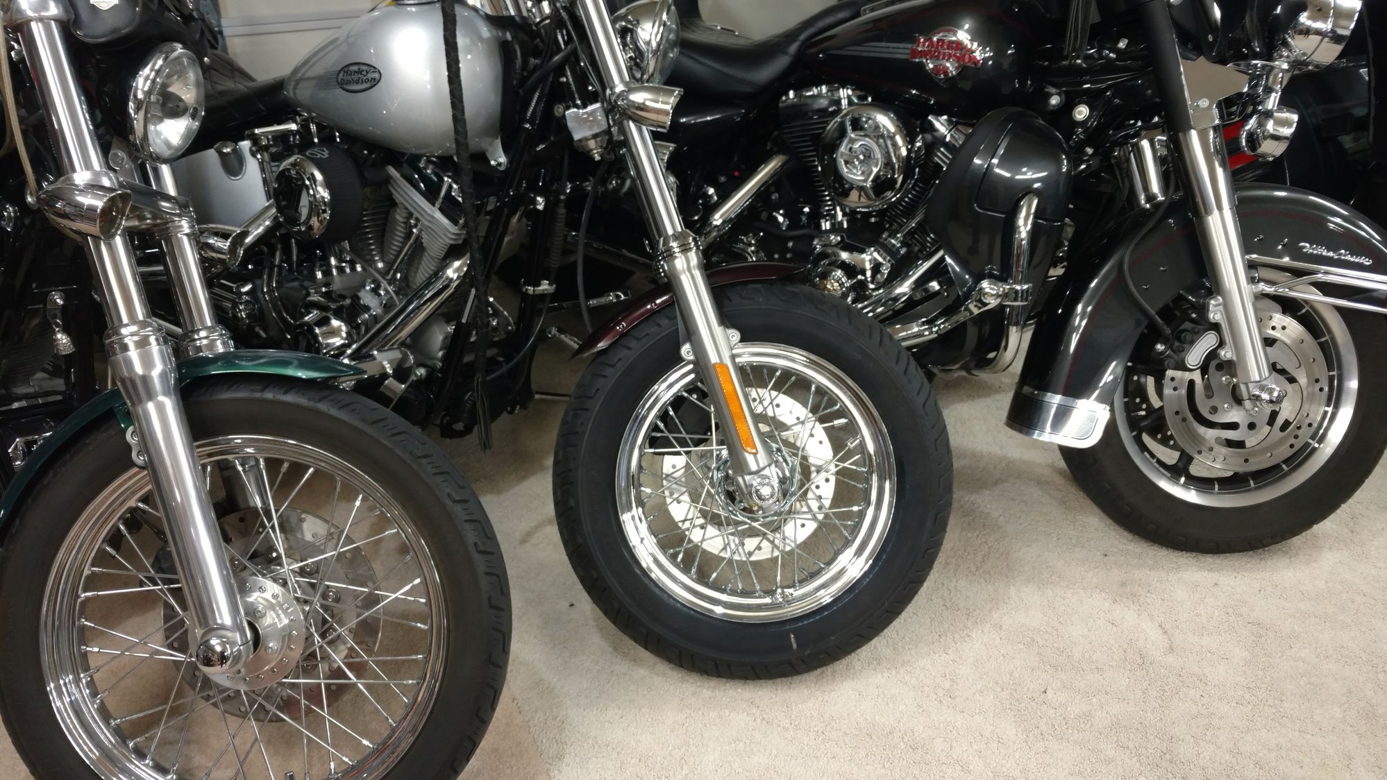

here is a photo of mine if yours looks the same your good to go!! On my bike the rotor marked right is on the air cleaner side and the one marked left is on the primary side I just went out to my shop to verify, valve stem on AC side
sorry it isnt closer best photo on my computer

Mine is the opposite. The Indy I bought it from must have mounted the tire backwards and flipped the wheel
