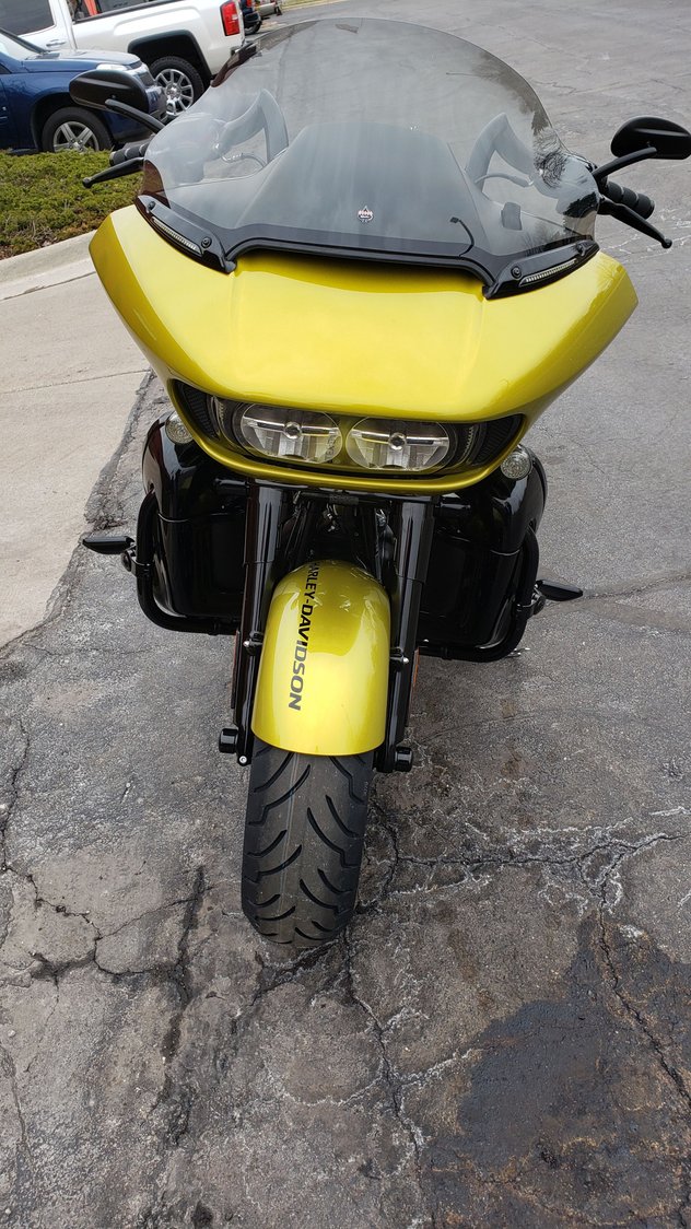

I run the AE 180 on the front of my 2020 RGS with the Native Baggers Fat Front Tire kit. And yes you have to run it backwards. When mounted on the back the belts in the tire are set up for the forces of acceleration, you have to reverse the tire for the front as the force put on the tire from braking would be in the opposite direction and would pull the belts in the tire apart. The only bi-directional tire I am aware of is the Perilli Night Dragon tire.
I will say I have put a few hundred miles on the bike since I did the fat front tire kit and the tire rides great, handles curves and sweepers with out any issues and is smooth and quiet going down the road. Good luck on your project......

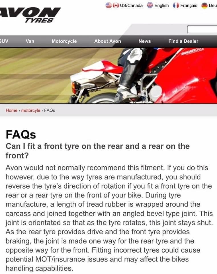

Front Native Baggers: If you look at a STOCK front tire the wide part of the chevron tread hits the ground first just like when we run rear tires backwards on the front. That is also the case with the Pirelli Night Dragon bi-directional tire so with that said Pirelli obviously thinks it’s ok to flip a rear tire backwards to install on the front seeing as how their PROFESSIONAL ENGINEERS designed their bi-directional tire to be ran that way.
From Avon:
