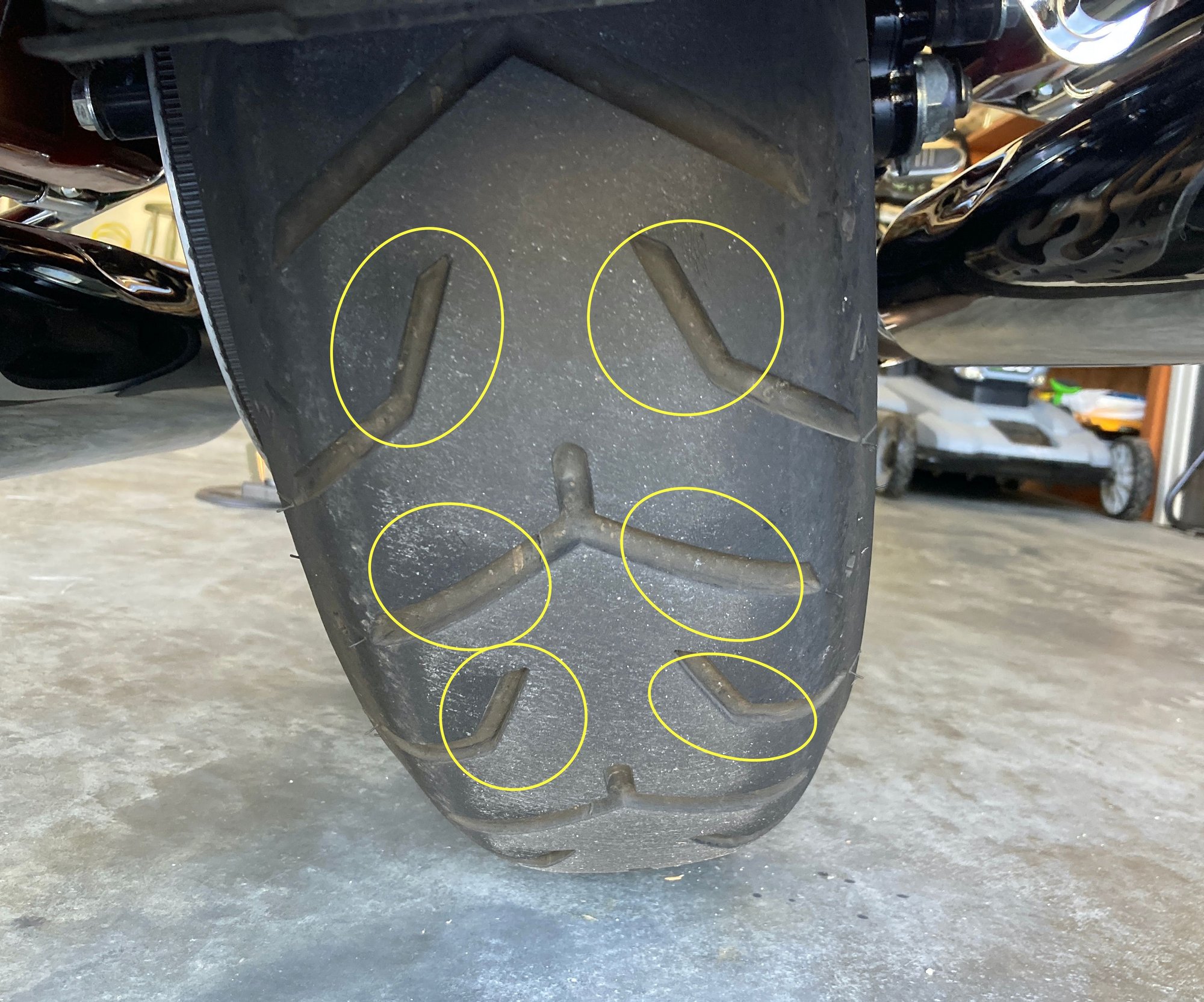

Yep. Tires. Rear tire specifically. Not apparent on front tire. I believe this is referred to as cupping. We called it feathering when I was a tire buster at Sears two lifetimes ago in school.
My FLHX started the same way after I bought it last rear. See wear pattern in pic below. That’s probably 9k miles. I’m at 10K, still with 5/32nds, but tired of listening to it so I’m replacing it tomorrow.
