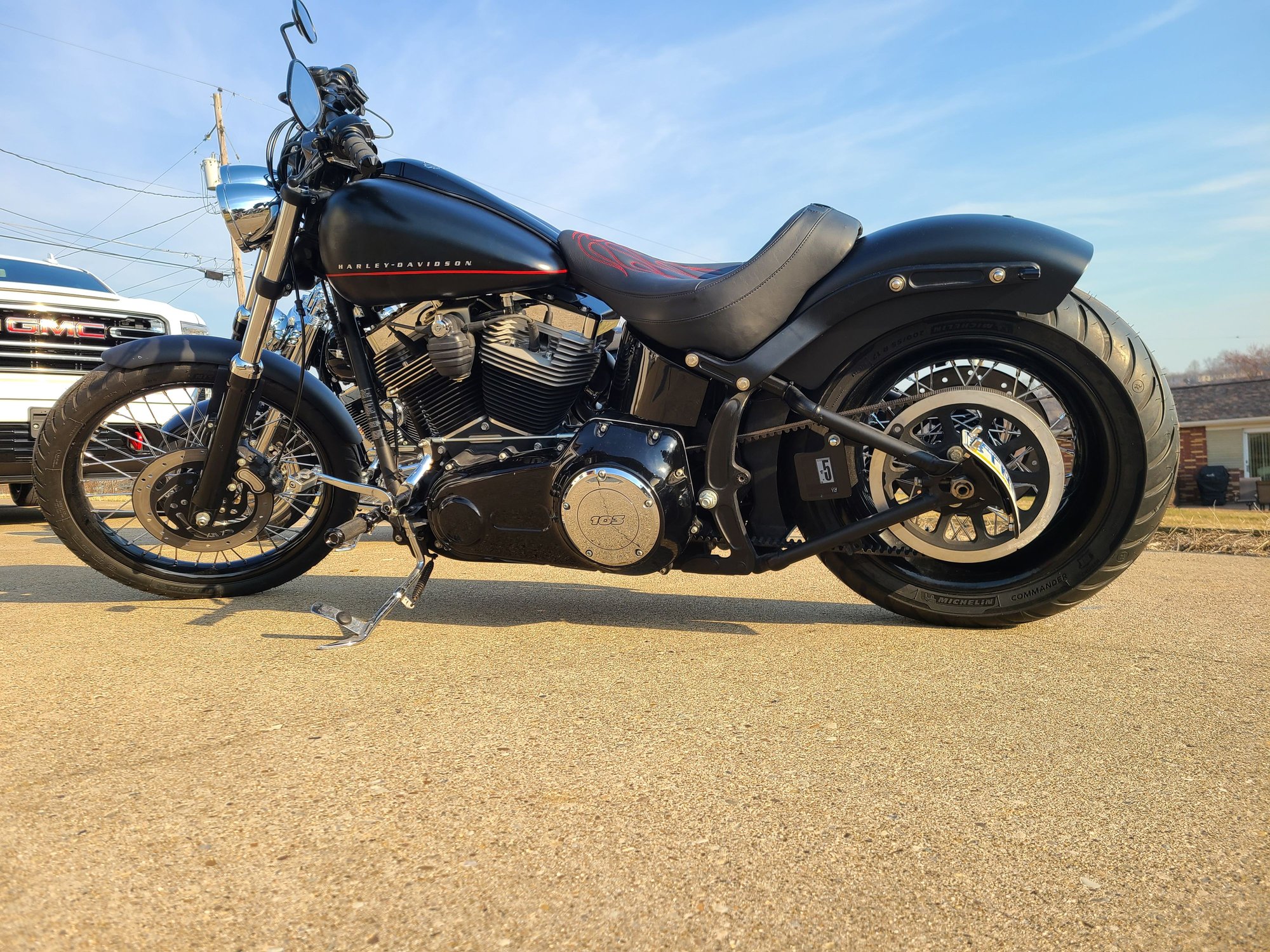

I did the same thing on my FXS. Over the winter I went with a 90/90 21 to go with the 200/55/17 I swapped in. It fills the front fender a bit more and finally got it out today for a quick ride. So far, I'm very very pleased with it.
Here's a pic of the 80/90 and the 90/90 side by side. There's not much of a difference, but it's noticable when riding. The 90/90 doesn't follow grooves as easily and feels more planted.
