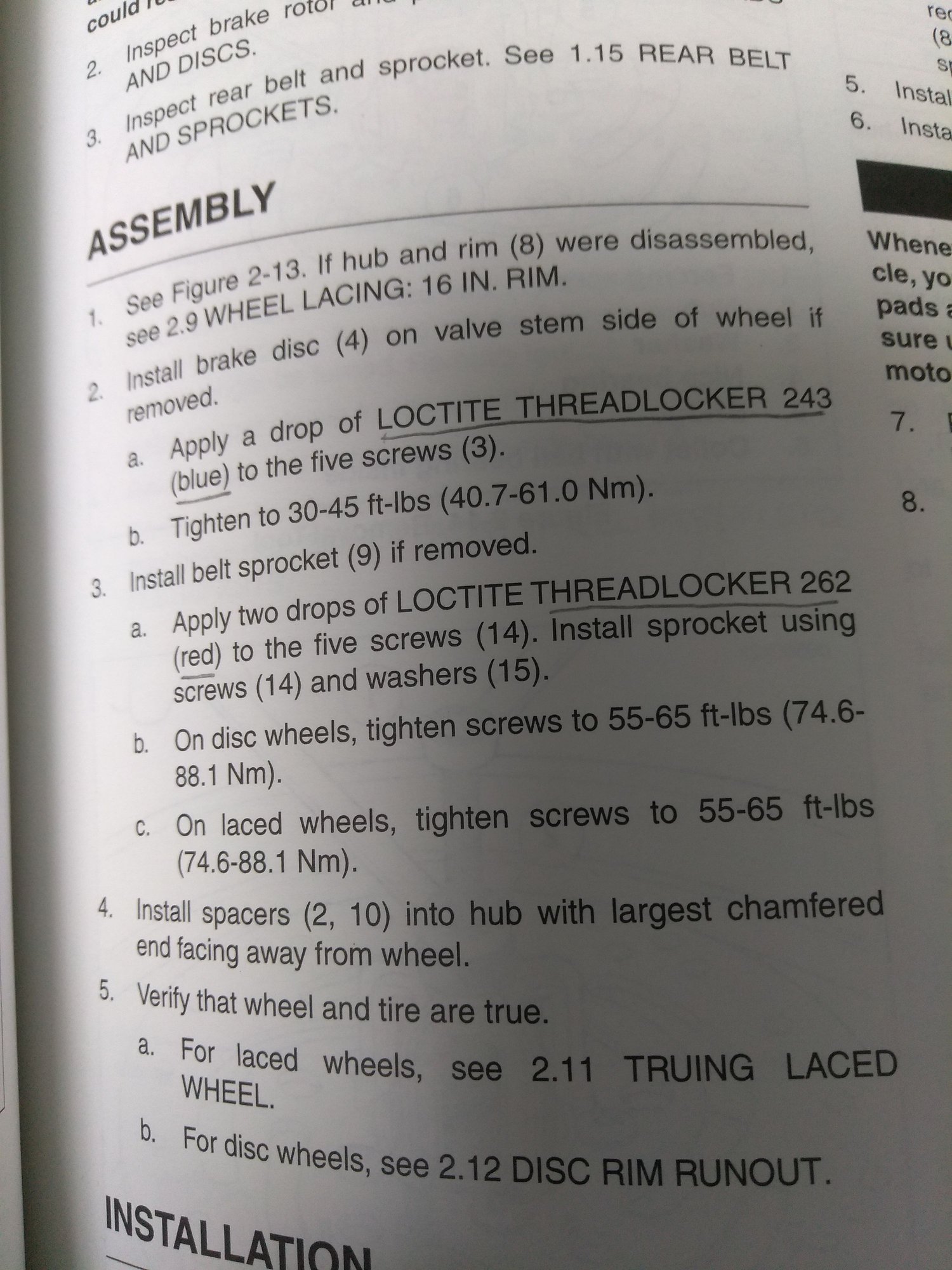

16 spoke aluminum mag i am going to use lock washers for sprocket and brake disc. What about a drop of blue loctite also. Will it mess up threads when trying to remove bolts later on?

Blue loctite is fine
You need to add a signature line about bike detail. All Harley's are not the same. However, this is a Softail and most are similar.
That rear drive calls for a permanent grade loctite. And this bolts are grade 8.

I use a threadlocker and torque down as per the service manual for that make and model.

Blue on brake disc, red on sprocket. No lock washers, just standard washers with new bolts.

Be careful with the lockwashers on the brake side, be sure the heads won't hit the caliper bracket with the added height, they tend to run close.

stainless seat washer, prevents gouging.
a split washer is really just a space taker.
