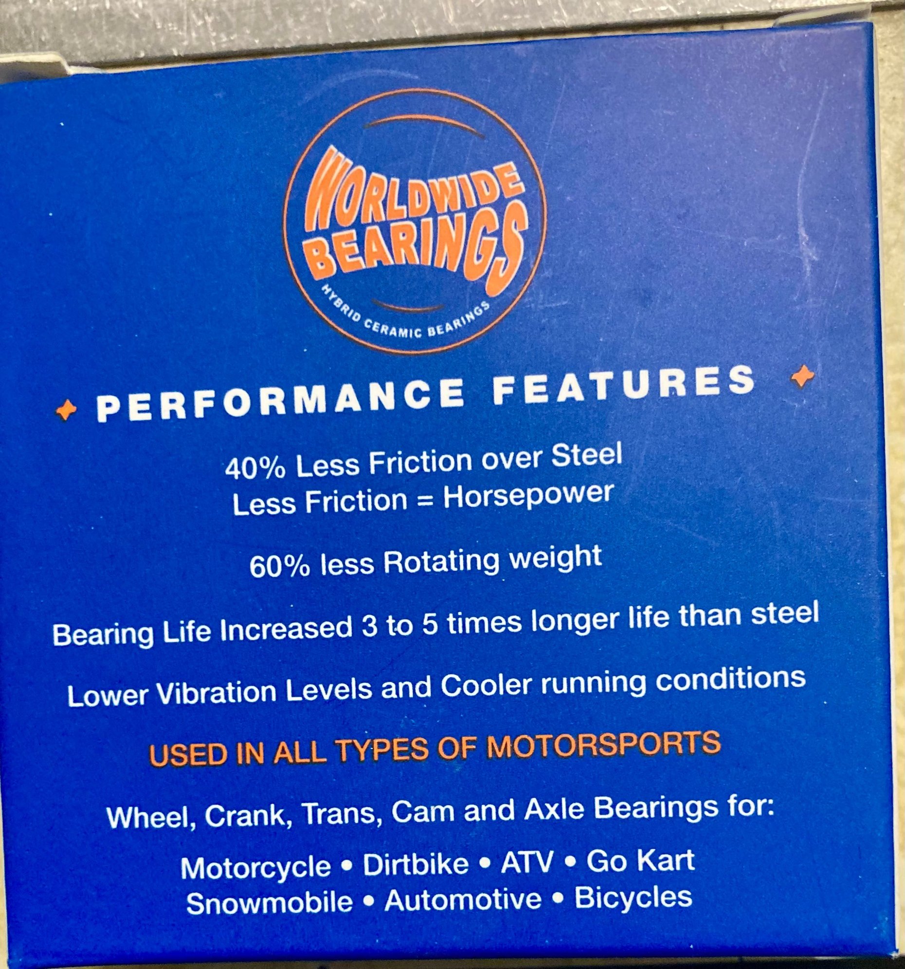

bklynbob's Avatar
bklynbob
Joined: Mar 2008
Posts: 4,998
Likes: 655
From: bklyn,ny
Old May 7, 2025 | 08:46 PM

Can I ask where you got the following bearings from?
