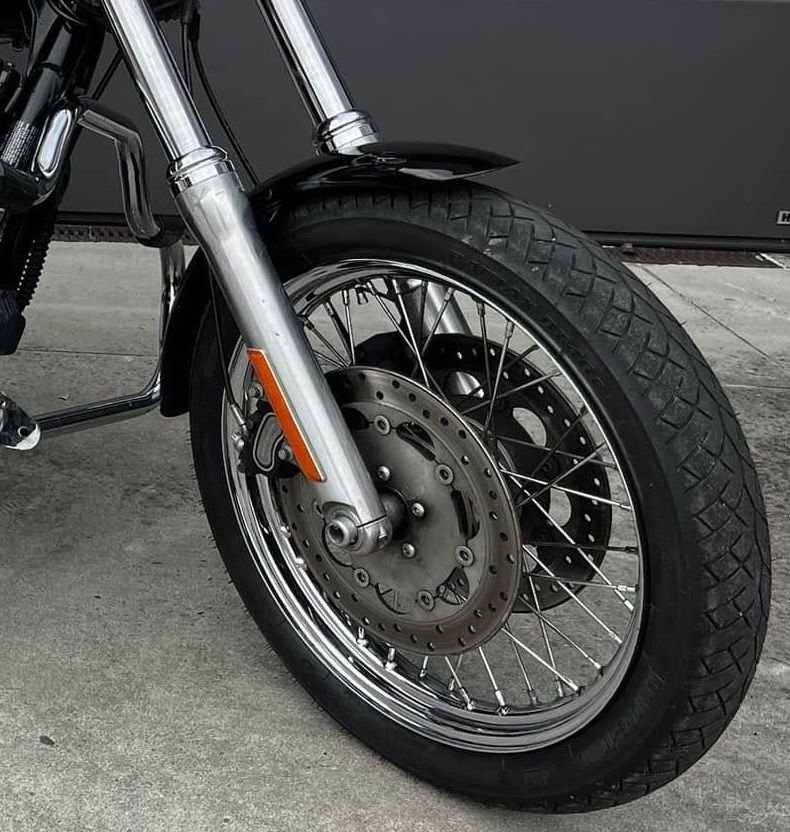

Hello.
Did Harley (if any) make any bike (model and year) with a 21 x 2.15" front wheel and hub for two brake discs? The photo is an illustration.
Thanks.

Originally Posted by ferokulda
... The photo is an illustration.
Btw, I was wondering what you were trying to illustrate with that photo? The only feature it has in common with the wheel you're looking for is that it has two brake discs
