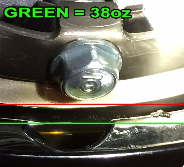

I went ahead and changed my fluids today to check things out. Like I said, I have always filled it up to the clutch spring like shown in post #6. This is just how I was shown to do it and I have always stuck to that. I put 38oz in the primary today and it's nowhere near where it normally is. I thought I would post this for clarification because like myself, lots of people believe that post #6 is correct. The red line in the pic below is the level I have always filled it to. The green line is apparently the correct level and it did come out to exactly 38 oz on my 2014 SGS.

Is that on the jiffy stand, or sitting level?

06SWGA, have any idea what it took to get to the red line on your previous fills? Know there is a lot of flack above about why not just do it to the manual. I am 100% on doing it to the manual and that is what this thread is about in my opinion. Problem it has taken Harley a long long time to actually state amount in the primary. I personally wrote it in my owners manual since it was not put there by Harley. Just the one picture showing it to appear at the top of the window. However, they did say bottom of spring but few people really know what is spring and what is spring retainer where the oil is in post 6. Could it be that post 6 is on the stand? Then the red and green lines could be both correct for level and stand.
