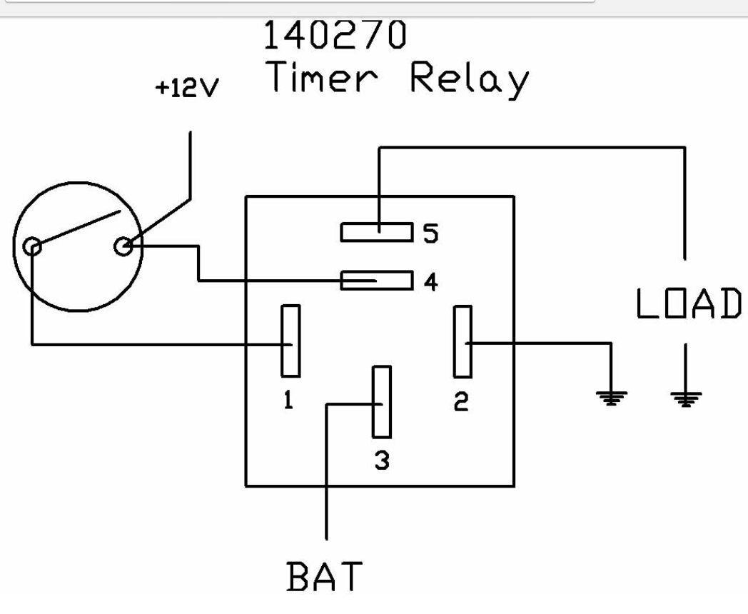

Had some time yesterday so I hooked up the relay. I also bought some relay sockets off eBay. Researched the simple wiring diagram and did it. Hookup was very simple and works like a champ. 10 second delay seems like just enough for me. I do not always wait for the acceptance screen though before I crank up. So may want more time if you do wait religiously for that.
I kept everything in the fairing and used the same 12v lead/location and used the ground lead at the same spot for relay's ground this time.
