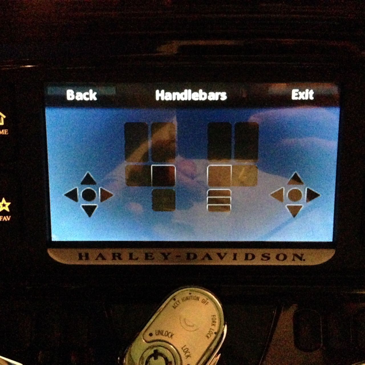

Go to the diagnostic menu on the Infotainment screen - and check to see if the switches work properly first. This will tell you if they are wired correctly or if they have a short.
