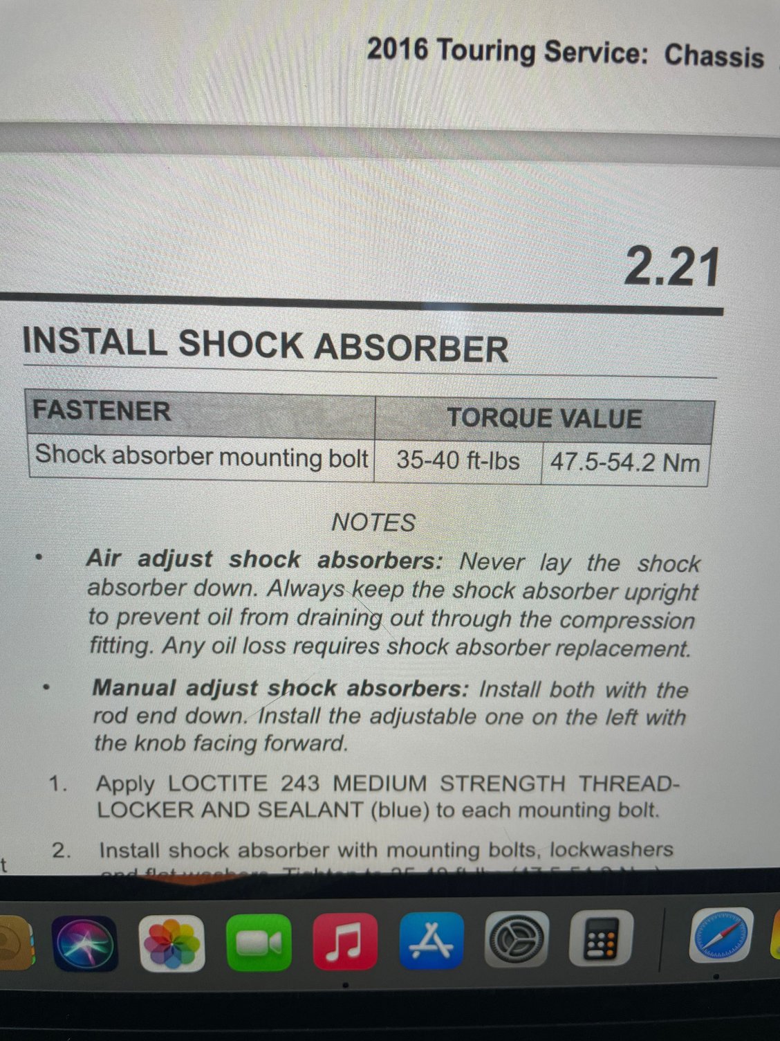

35-40, where did you find 63-70??????

Originally Posted by jmatero
Apparently, pre-2017 models (Rushmore non-M8 are 63-70. That's what I get for using Google LOL
negative, my manual for my 2016 clearly states 35-40...

I did look here first and found this same image stating 30-40 Rushmore non-M8, 63-70 Rushmore M8. Can't see any reason why a 2021 with the same shock/bolt/washer part numbers as a 2020 would not have the same torque rating. The Legend instructions simply say "install shocks"... that's it. But when I called they said they recommend 50. Their YouTube video says to "see your factory service manual for torque settings".
