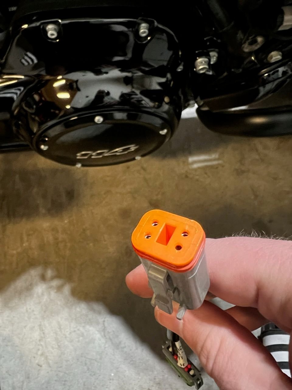

I can’t believe I’m here asking for help with this, but here I am. I’m trying to install the H-D combo analog speedo/tach on my 2020 Road King Special. I installed one of these on my 2018 Road King and don’t remember having any trouble.
When I plugged it in where the factory speedometer plugs in, it gave me a NO CAL readout on the LCD. A quick look through the instructions says it needs plugged into the 4 way connector on the bike (data port) using the harness that’s included. Okay, fine. But I can’t find that anywhere. I’ve looked under both side covers and under the seat.
I’m pretty sure this was supposed to be a plug and play, as others have indicated on the Facebook groups.
Could the PV tune be causing any issues?? How do I fix this?
Here is the plug and the instructions.

I believe that the data link connector is located behind the left side cover. Should be Light Grey in color with a black rubber plug installed.

There is a connector there but it’s not a four way.

What is the part number of the kit?
Yep, that is the issue alright. Wife got it for me for my birthday and ordered 70900070B. Looks like a different PN for my bike. Thank you!!
That's why I asked. The data transfer cable had me scratching my head. It was used on older models.
