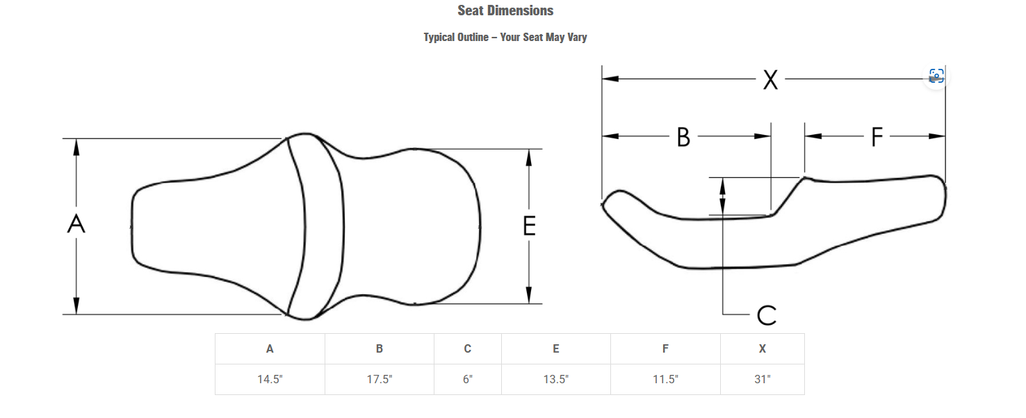

I don't know if it will help, but it might. This is for the extended reach. I had one, but don't anymore. I can say that the difference was pretty much spot on what they said it would be.

So if you add the "B" dimension (17.5") to 8" (tip of the seat to middle of ignition) = 25.5" for the extended reach road sofa...gives you one of the seat dims you were looking for...no?

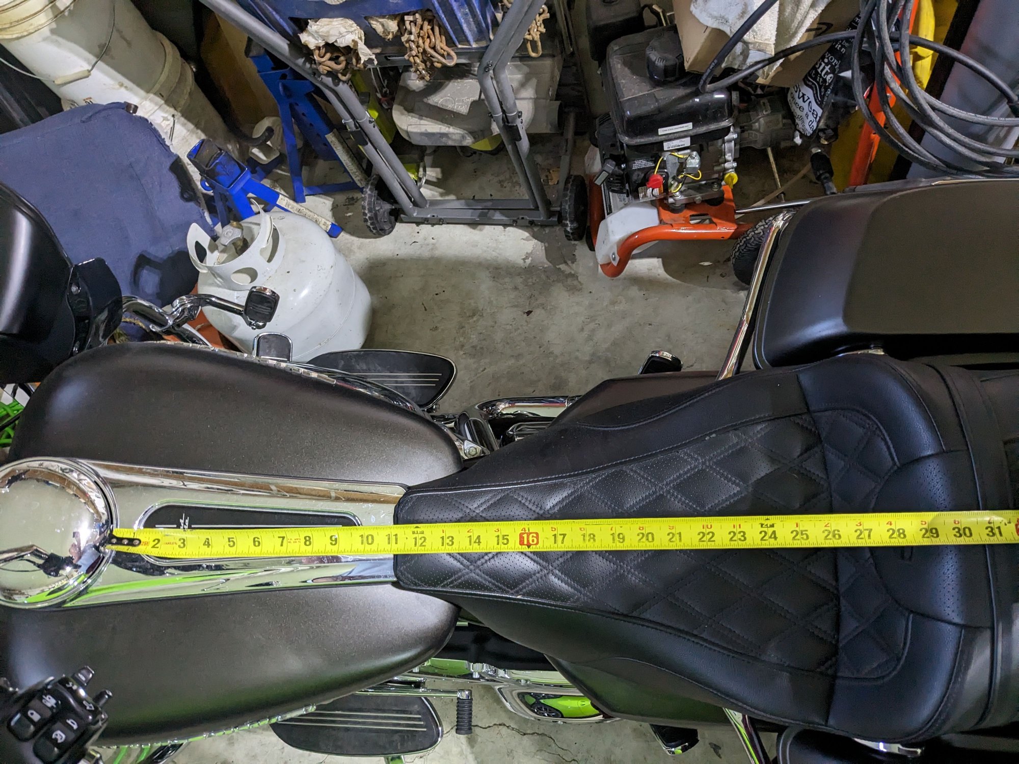

My bike is a RG so I don't have the ignition switch on the console. I have the Road Sofa Extended Reach seat. I, 6' 230 lbs with a 33 inch inseam. The seat and riding position is miles better than the stock one. However, I did need to install to bars as I was too far from the stock ones. I went with KST 14 in Pathfinders rotated back slightly. I measured mine from the edge of the gas tank cover lip which would be about the same as your speedo bottom lip. 27 inches. (pic is slightly distorted). Hope this helps.
F
Thank you RevBlk. This answers my question. From your photo it looks like this seat overlaps the back of the tank by about 2-1/2".
