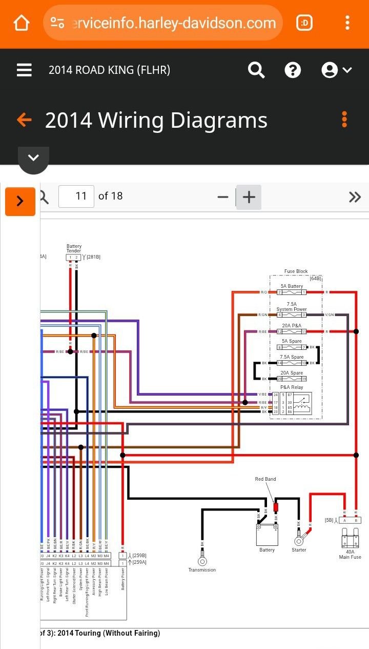

I have this sae connector under the left side panel of my 2014 road king (title has typo I can’t edit ). It’s not getting power as tested on my volt meter. It appears to go to a bundle of wires next to the frame. Can anyone tell me about the other side of this wire?
Where is it?
How can I find it without taking the whole bike apart. Does it have a fuse?
I need to check both ends and troubleshoot the no power situation.
thanks

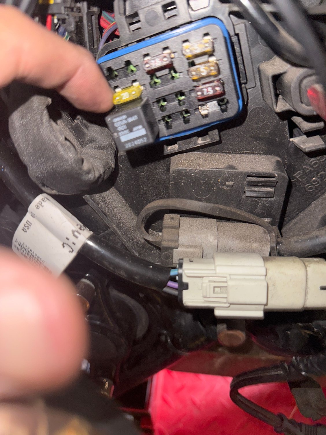

Is it the p&a fuse here?

I checked the all in the box, none are blown

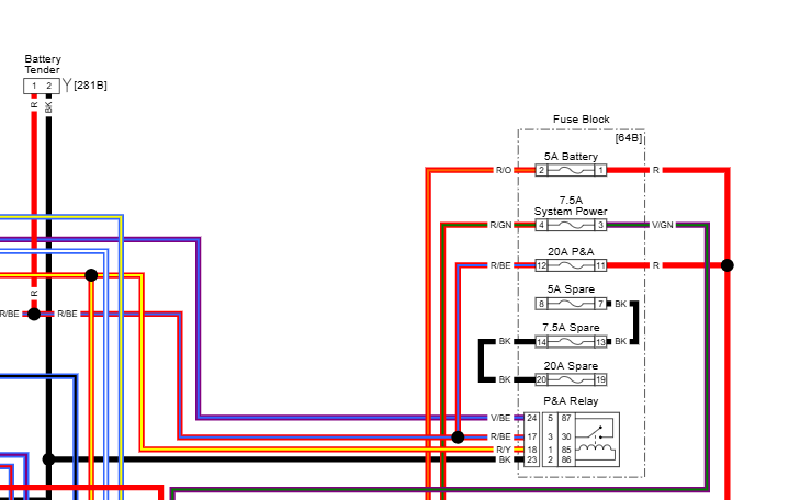

Replace the P&A fuse.
There is no in line fuse.
Yes.
Don't rely on a visual check, use your meter.

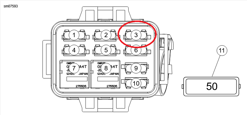

Check fuse #3, it is the battery fuse, 5 amp. Remove and check with a meter.
See below.

The battery tender is on the P&A circuit, protected by the P&A fuse.
