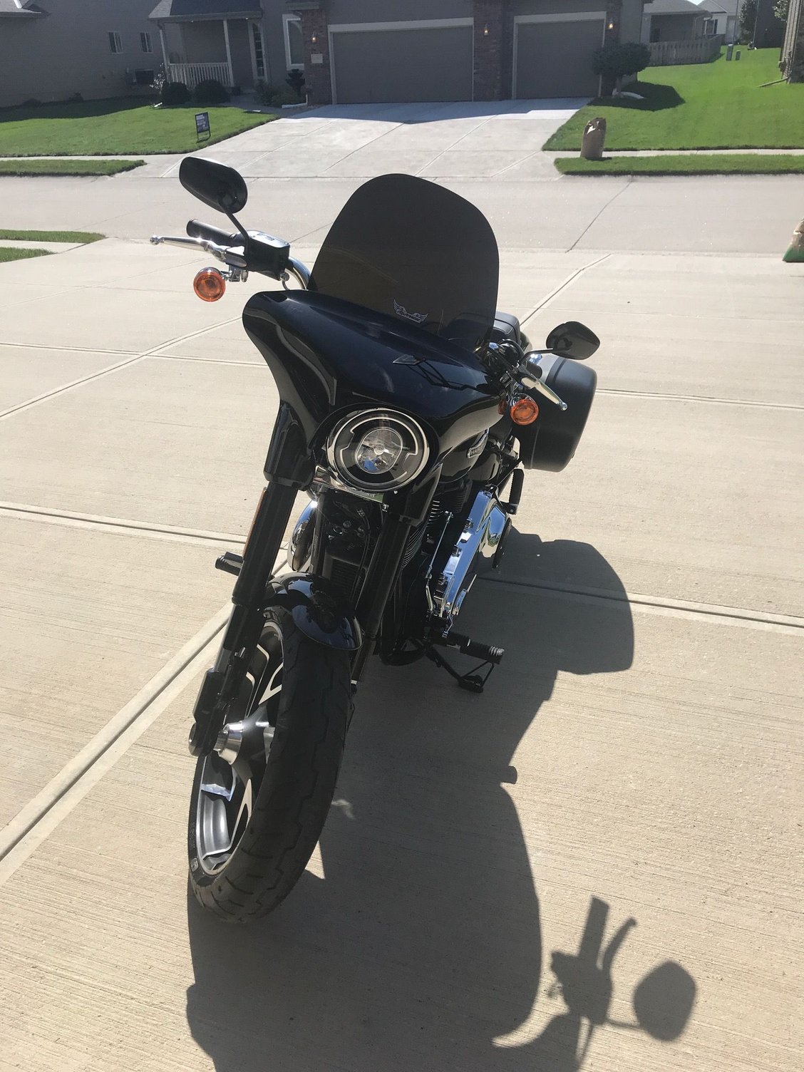

Here's my 2018 Sport Glide with a 12" dark smoke Slip Streamer windshield. Took it for a highway ride and it made a big difference with reducing wind buffeting. I'm 5'10" and the height of the windshield is perfect. The edge of the windshield did rub on my clutch cable, so I zip tied the cable to my handlebar and problem solved.
