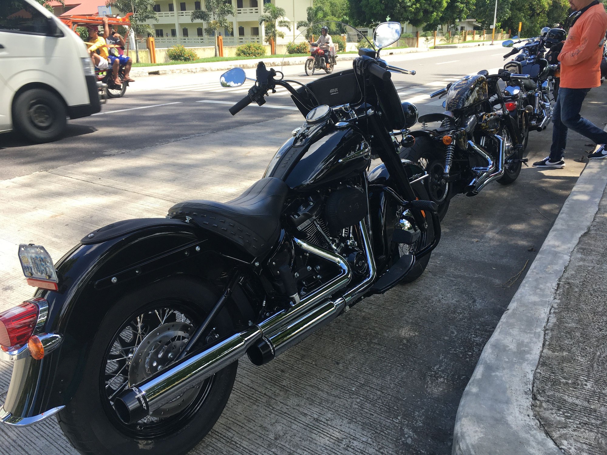

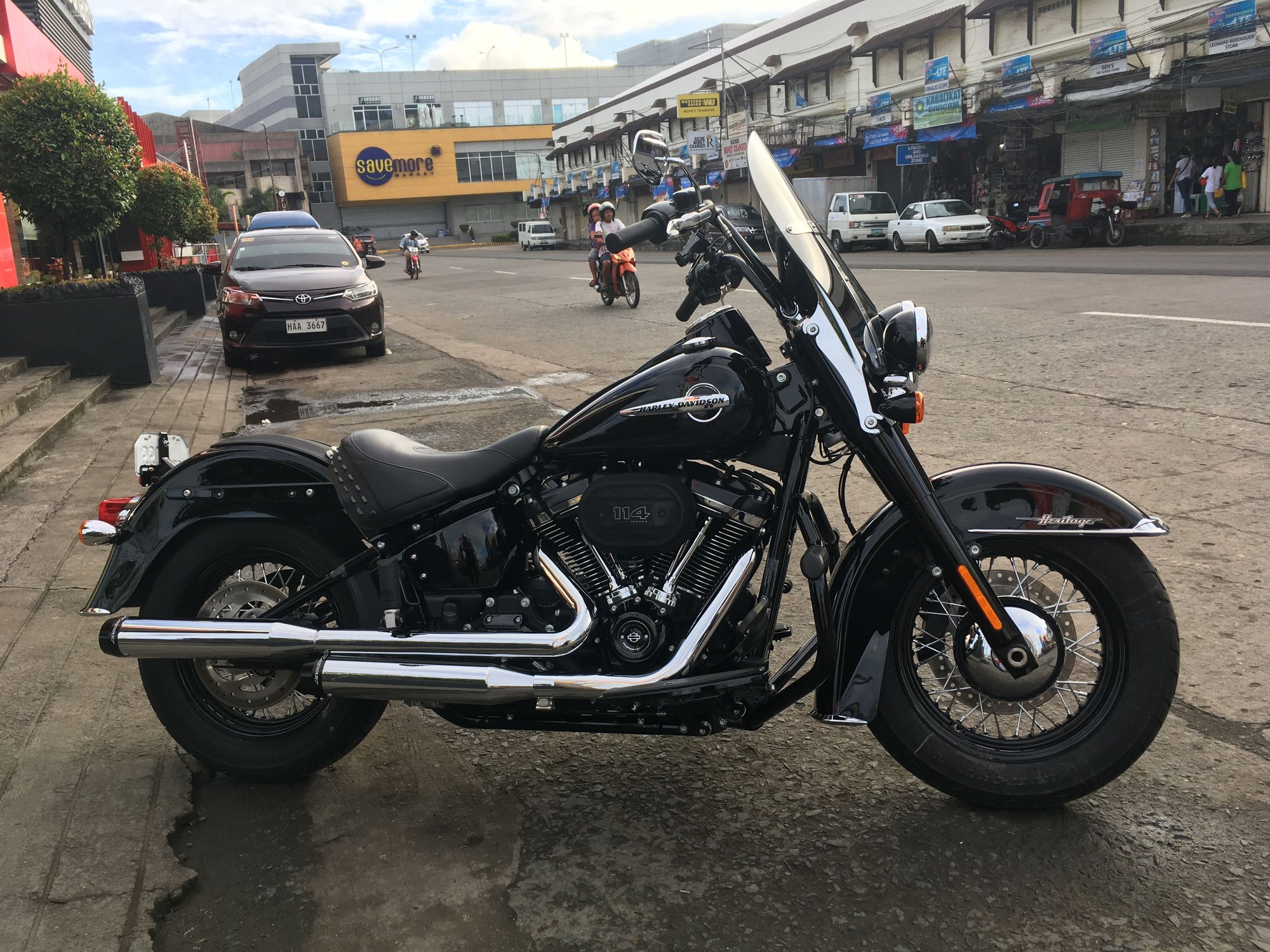

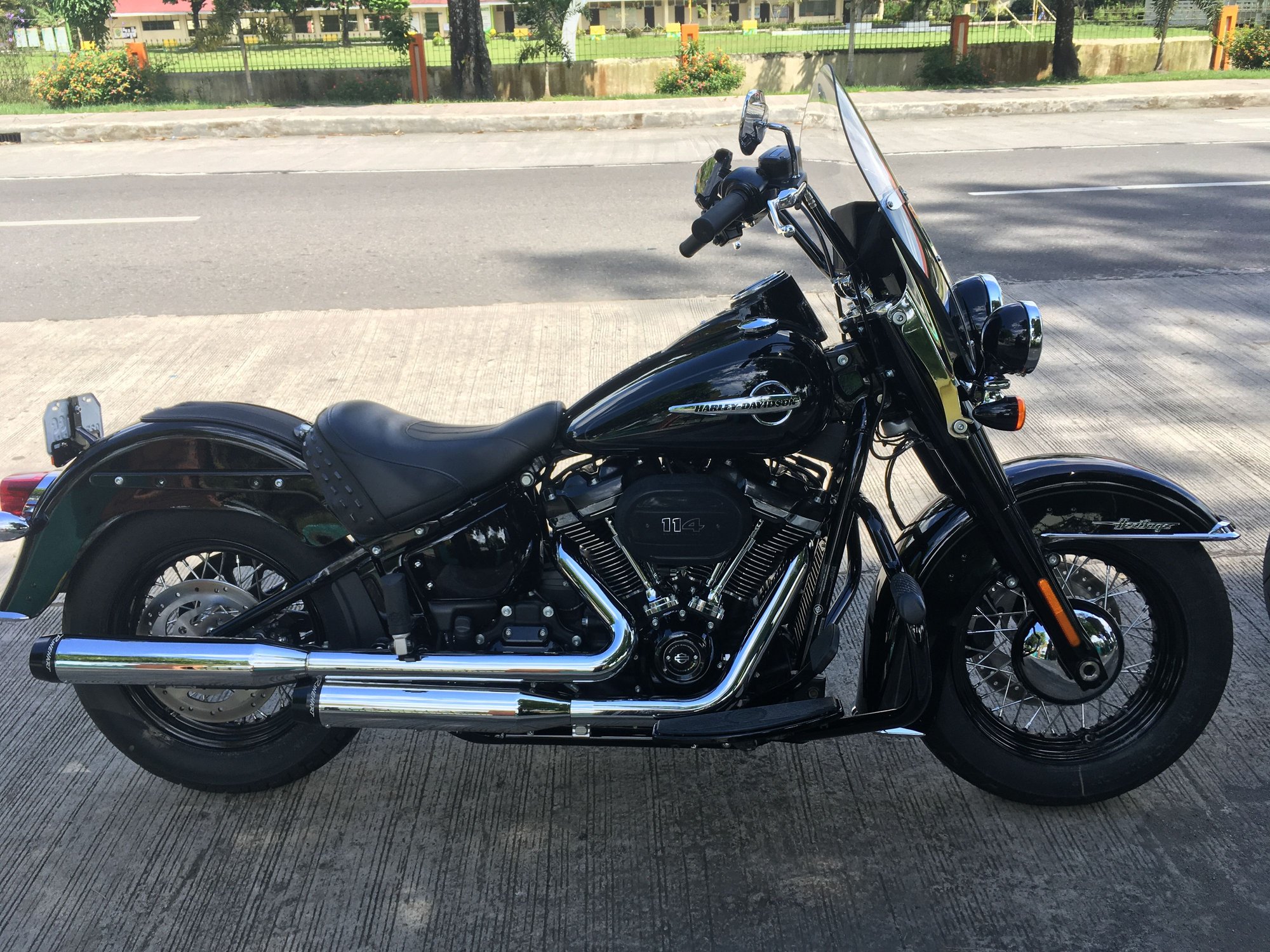

100km Breakfast ride with Harley Owners Group of Tacloban

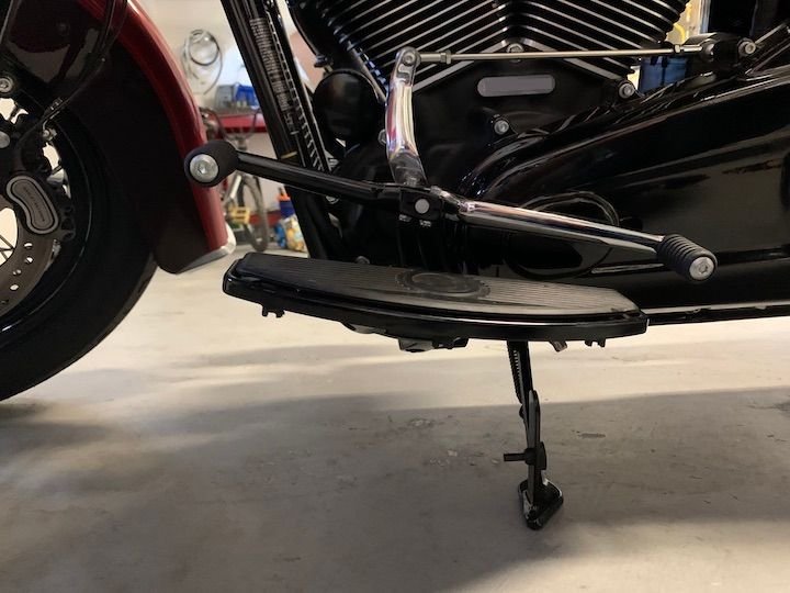

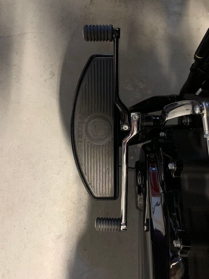

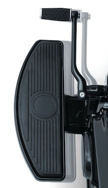

So, this is my first Harley and my previous Triumph Speedmaster had large floorboards with a brilliant heel/toe shifter. The heel shifter was positioned perfectly and did not interfere with foot clearance. With the Heritage, I've always felt my legs/feet were cramped. If you have a 107, the air cleaner is HUGE. The heel shifter from Harley is too short and cuts into foot space terribly. So after a little work, I can tell you I've now achieved heel/toe nirvana. First off, if you have a 107, consider moving to the Screamin' Eagle Ventilator (like on the 114). It 's AMAZING how much more room you get on the right side. Then, do yourself a favor and install the Kuryakyn Floorboard Extenders. It's shocking how much this quick, easy upgrade helps.
I installed the HD Heel Shifter Kit. It stinks that it only comes in chrome but you can powder coat it ($$$), order a black shift lever from HD (Part# 33600243 - $$$), or buy one off eBay for around $20. Also, I mounted the heel shifter on the inside so it's not in the way of the floorboard and I don't lose foot room.
Finally, I ordered an 2ź" extended shift lever. I got mine from eBay but you can get a 1˝" extended lever from Dennis Kirk as well. The 2ź" extended shift lever is PERFECT because it moves the peg behind the floorboard, and allows you to drop the position down so it's not sticking up so high. I'm VERY happy with the results and I'm just trying to determine whether to power coat it black, or use the chrome lever from the HD Heel Shifter kit for the toe and go all-chrome. Hope this is helpful!

Thanks for the info., I too have been looking for to do the same on my Heritage. IS it only the heel shifter that is extended length? For a reference can you tell my what size shoe you wear?

Thanks for finding these short 3/4" extensions. Others are all too wide for what I want.
The link to Dennis Kirk is for the same 8 1/2" Center to center lever arm Mid USA # 44217. On sale for $19.27
I'll put the chrome lever from the heel shifter kit on the front.

Does the heel shifter help you find neutral easier? I have hell sometimes finding neutral on my Heritage.
