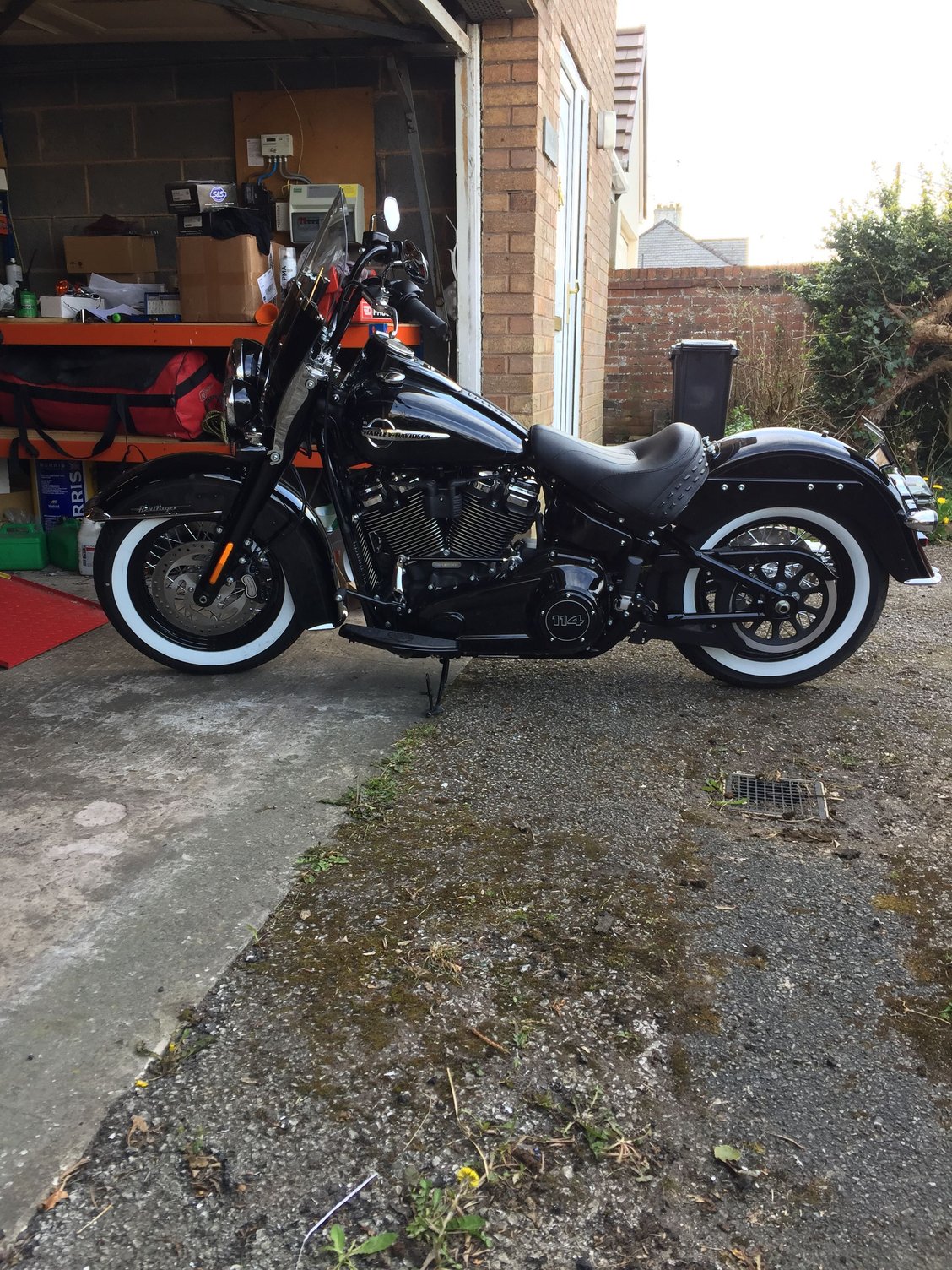

Default Got mine at last
2020, managed to pickup just before lockdown here
With whitewalls! Nice.
