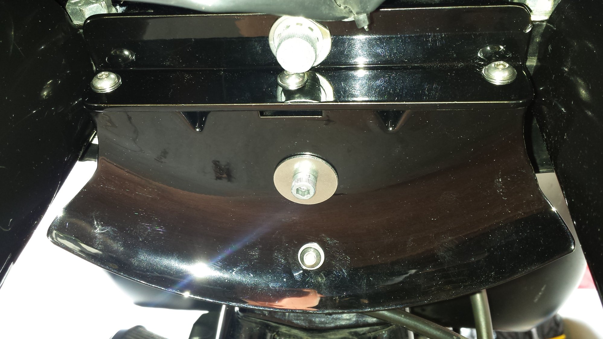

From a post by WKNDS, "I use Harley 'fangs' and have a Touring model 'dawg dish' (baffle)
added below the triple tree on my <2018 FLS..."
WKNDS, any chance you can post a pic or details on your 'dawg dish' baffle? I'd
like to see if I can mount one on my FLHCS.

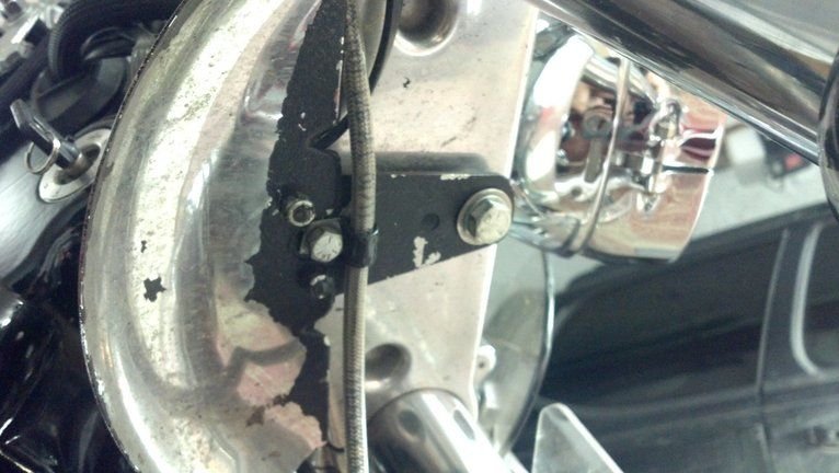

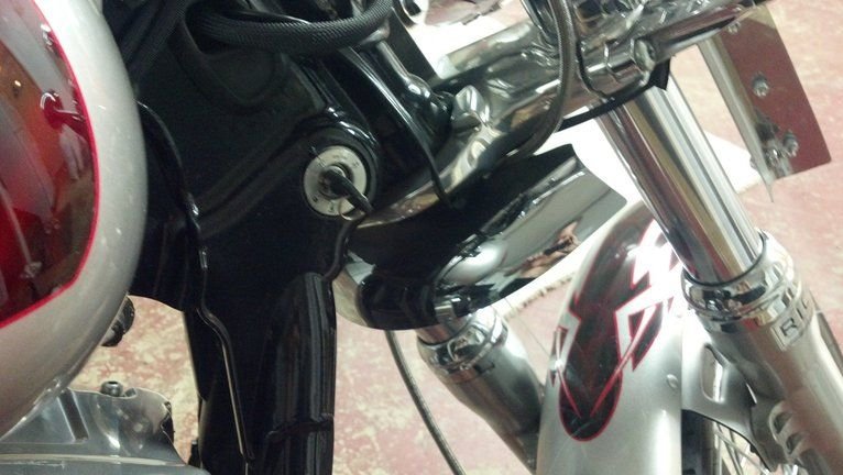

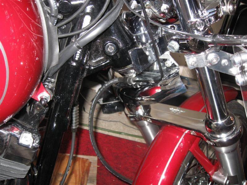

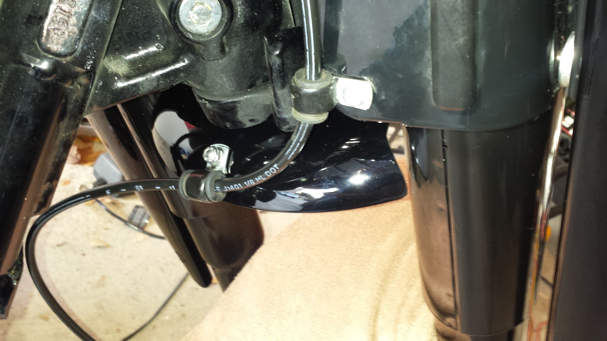

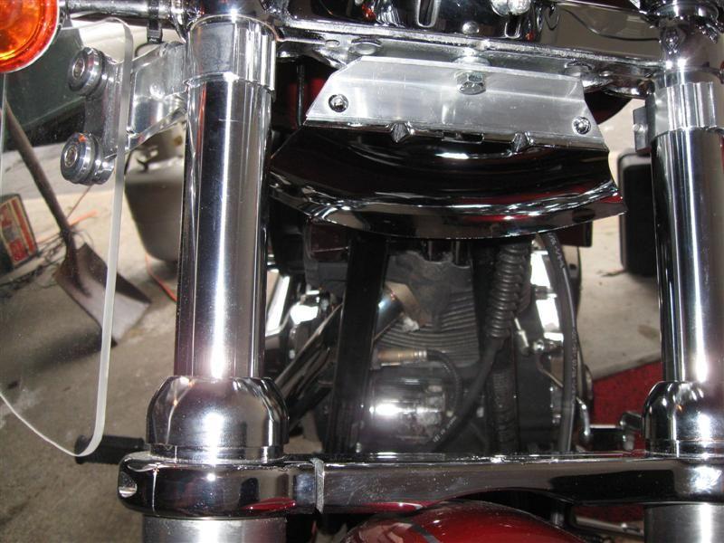

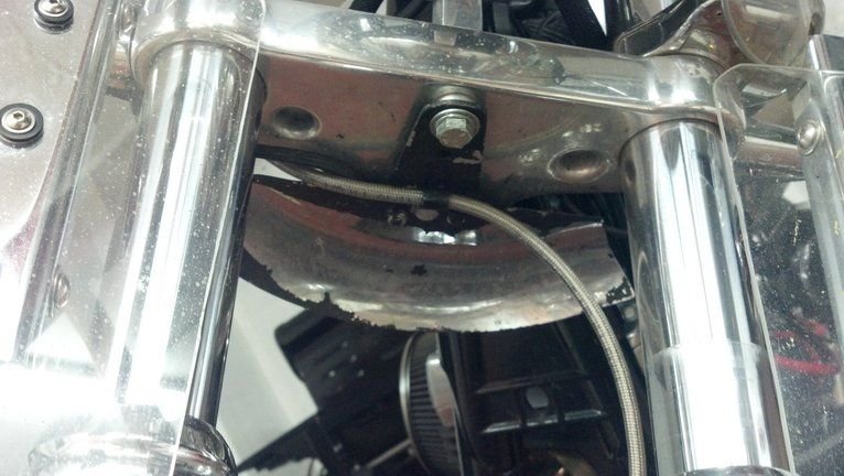

To find more, you can use the Advanced Search, there are quite a few examples
from over the years. Here is mine though.
A piece of aluminum angle was used on the 'front' flange of the baffle so that it could be attached to the underside of the tree.
Here's a few pics I found from Search;
hth,
T.

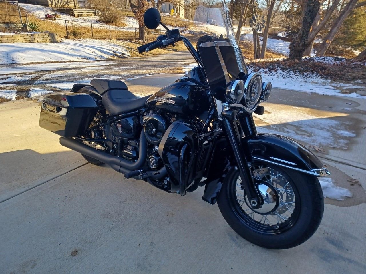

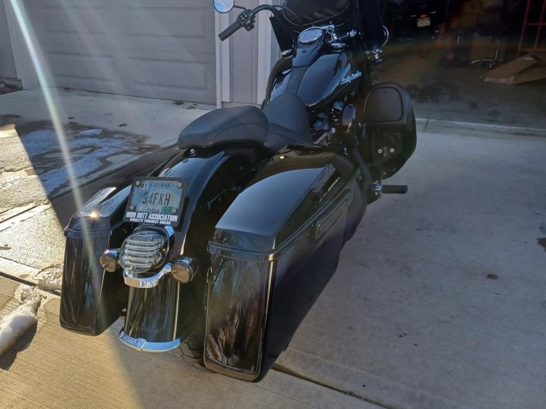

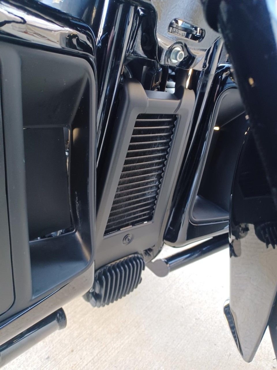

Ebay lowers, $100 in black, TCMT brand IIRC. Clearanced to fit downtubes, not perfect but was an experiment. Don't provide as much wind protection as I have experienced with touring models (spoiled by shark), but bit warmer on 40 deg rides. NO ZIP TIES. Mounted to HD engine guard same as touring. Stock hard bags were installed with HoqWorks brackets. Used to be a Heritage, now I don't know what to call it. Works for me. After commuting all week on the small bike, this is a blast to ride.
For those who would say "If you wanted a touring bike, you should have bought one", I've ridden LOTS of miles on thousand pound HD's. I'm extending my riding life on lighter bikes now. Which happen to have a MUCH better suspension than the touring models.
Hey, one more question......do you think these lowers will work/fit with the OEM floorboards? I see you have converted to pegs, so wondering if the floorboards extend too far forward to mount the lowers without more mods.
