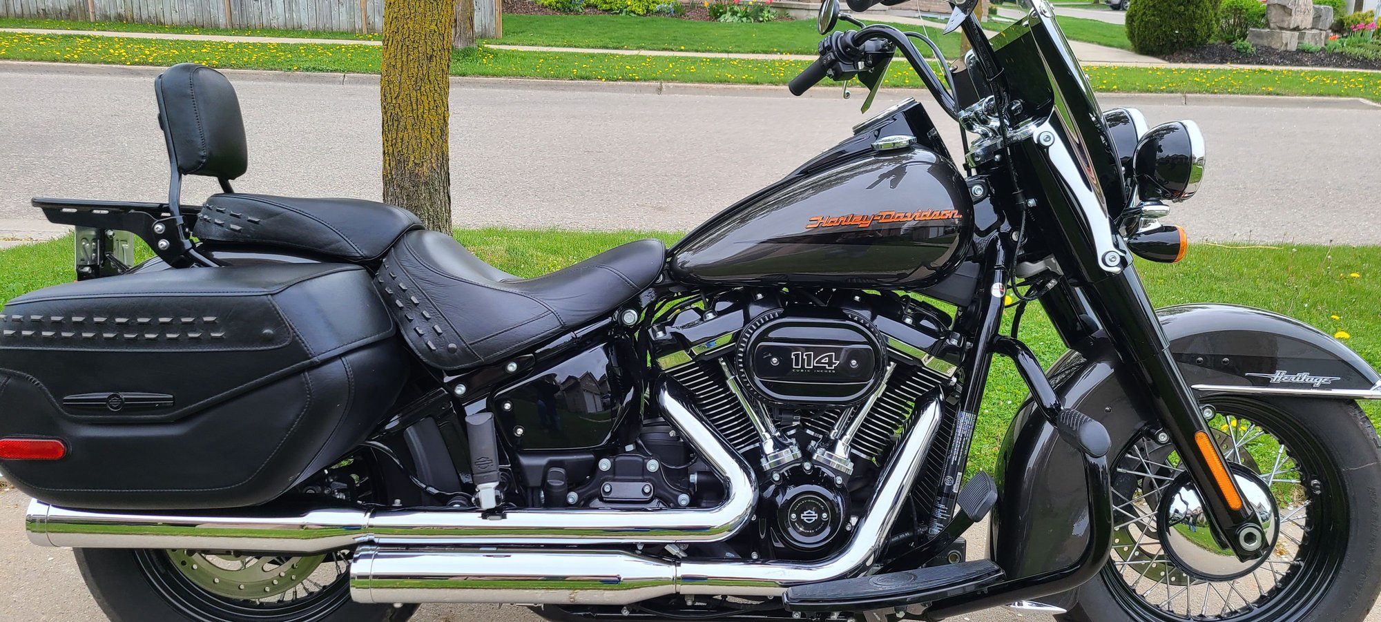

My new bike 2019 Heritage Softail Classic

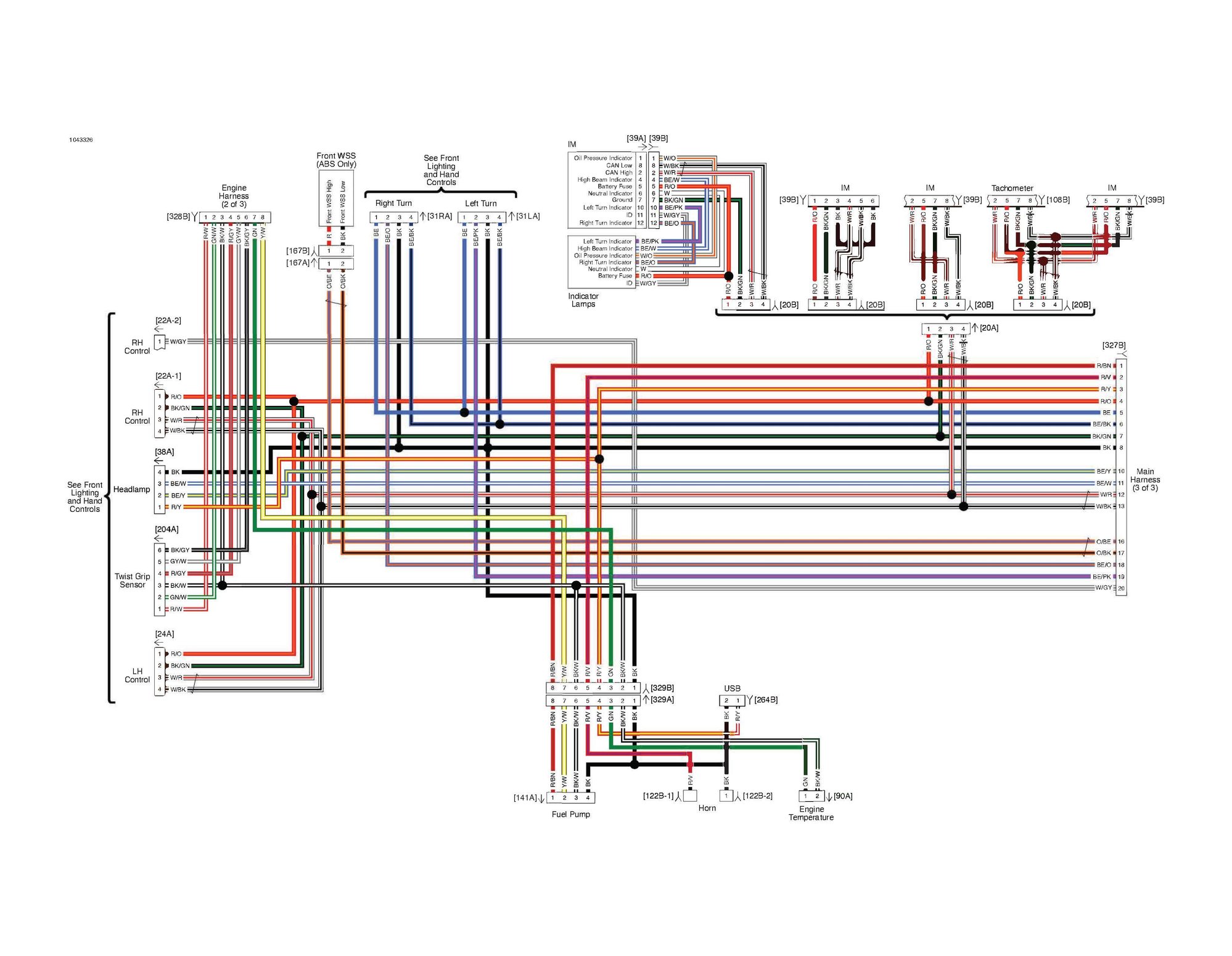

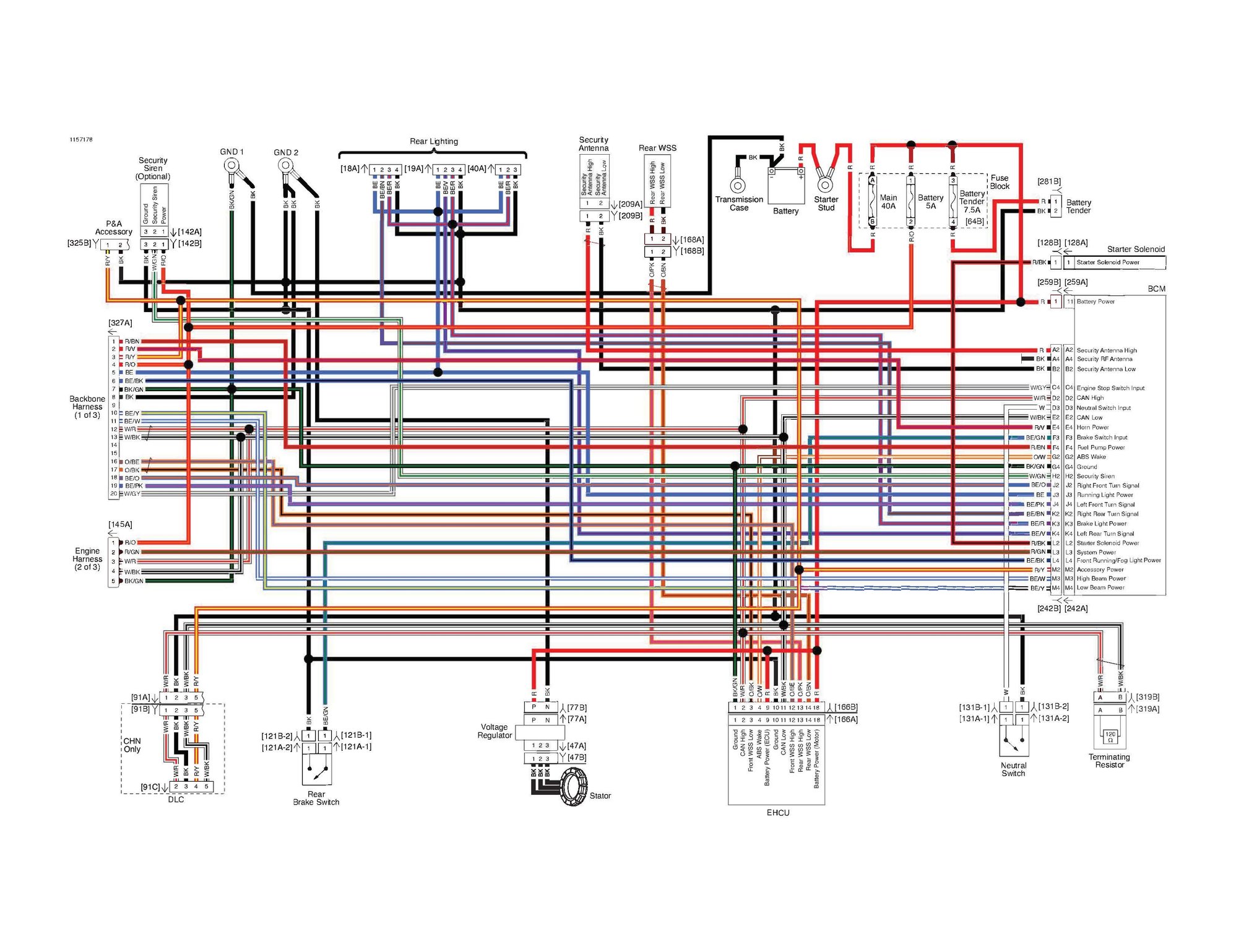

I'm going to be putting a HD garage door opener on the bike and I have to wire the white wire to the blue/white wire , The wire is in middle of ( i believe )of the main harness under the seat , so I have disconnect it to work on it , other then removing the main fuse is there anything I have to be a where off , And how hard is it to disconnect with breaking it , Don't want to throw any error codes

Bring you key fob close to the bike, turn on the ignition switch, then remove the main fuse. It keeps the security system from activating.
Looking at a wiring diagram, the white wire with a blue stripe is the high beam headlight wire. That is not what I think you would want to attach a garage door opener to.
The yellow with a red stripe is your accessory wire. Both wires run to the headlight and can be accessed under the fuel tank just behind the steering head.

Thanks for help , But yes the blue /white wire high is the right wire , You use you high bean switch to open the grange door...
Just can't get the harness off to where I can work on it .
Just a update , got it all working , couldn't get the harness off , but with some effort I managed to isolate the blue/whit wire and connect it ..

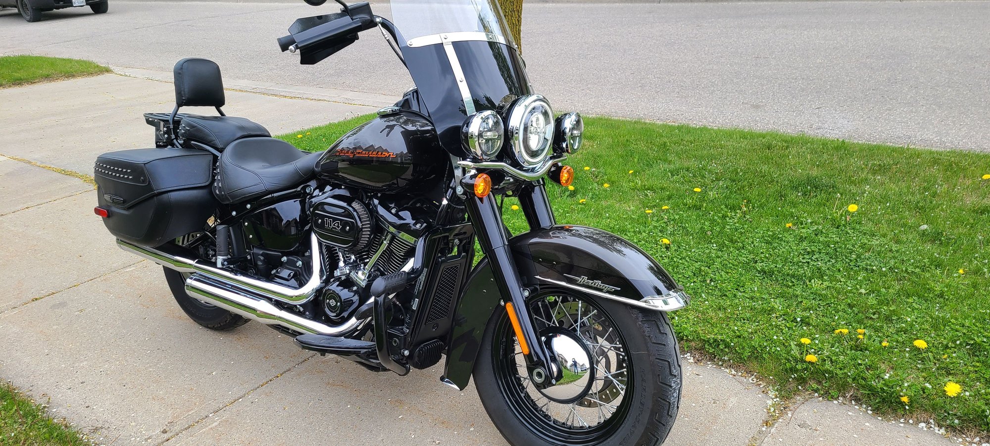

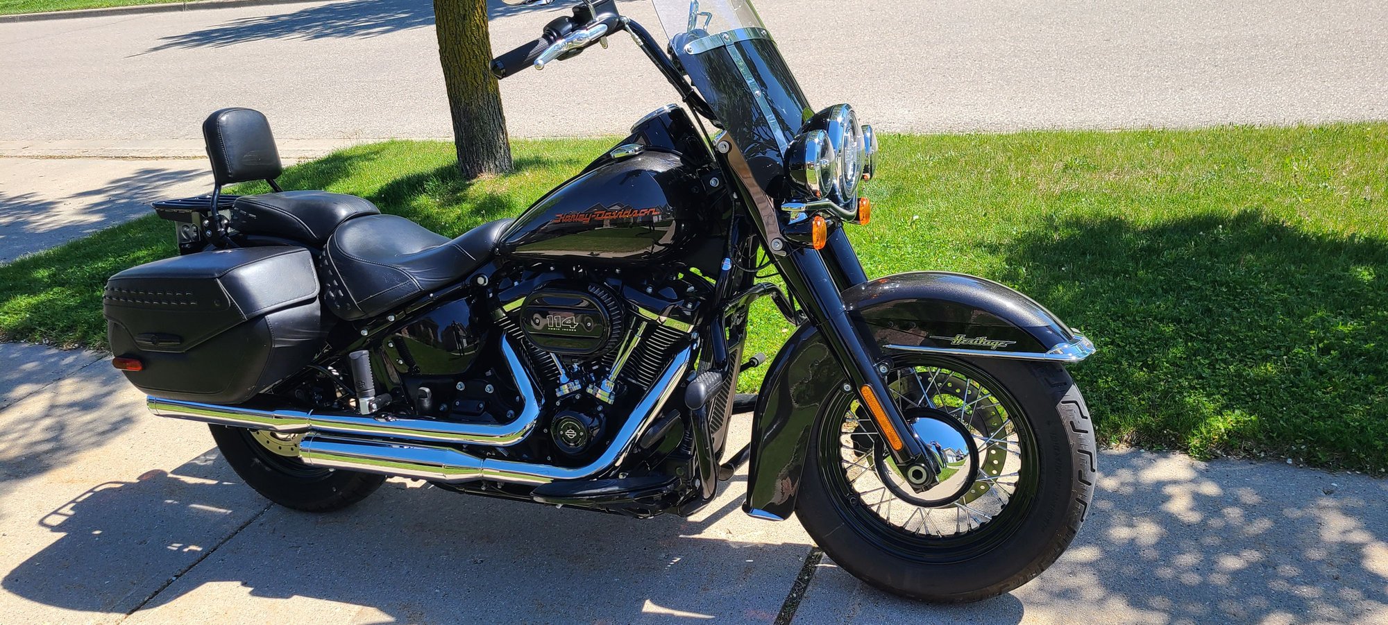

Took off the hand guards and put the oem mirrors back on , with new Avon grips

That's a beauty, love the color.
