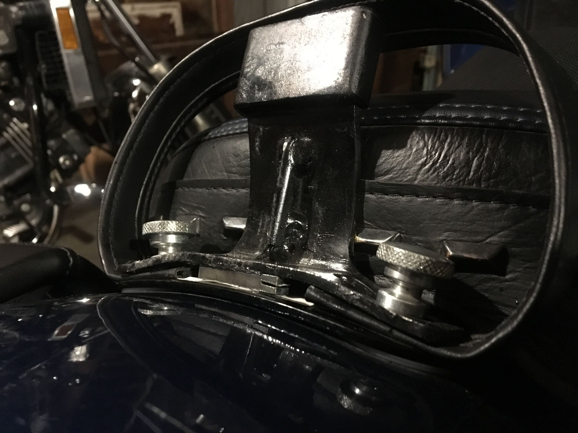

http://www.grasshopperlimited.com/ha...-softail-2018/
Mine was bending back when I hit the throttle, (and when I was using my bike as a lawn chair )
So I reinforced it with a little steel and weld. No problems now, but it looks bad. No hurry to make it pretty though , since I leave the rear seat on anyway.
I recommend tightening those thumb nuts with a pliers. Be careful not to bump the screws, they are held in place by thin sheet-plastic keepers and it is difficult reaching up in the fender. Trust me, lol
The shim underneath was necessary to lever the whole bracket forward and make up for the thickness of the grab strap. The grab strap is sandwiched between the Grasshopper mount and the seat pan mount, which kept the seat lower but sacrificed the integrity of the backrest mount.

The Grasshopper seems like a bad engineering idea. There is not enough strength in that mounting method. Just spring for the proper seat.

Just how I dealt with it, redesigning a little, it's about $300 cheaper this way. It would work better without the grab strap, but I wanted to keep it on.

Curiosity getting the better of me. Why are you keeping the grab strap? Most owners take them off and chuck them out before the get the bike home Mine is in a box with other stock parts that will go with the bike if and when I sell/trade it.
In its proper position my Grassopper works great for me, but I don't lean on it (like a lawn chair). I use it just to keep me keep me in the saddle, so to speak, and sitting up straight while providing restraint to rearward movement while accelerating.

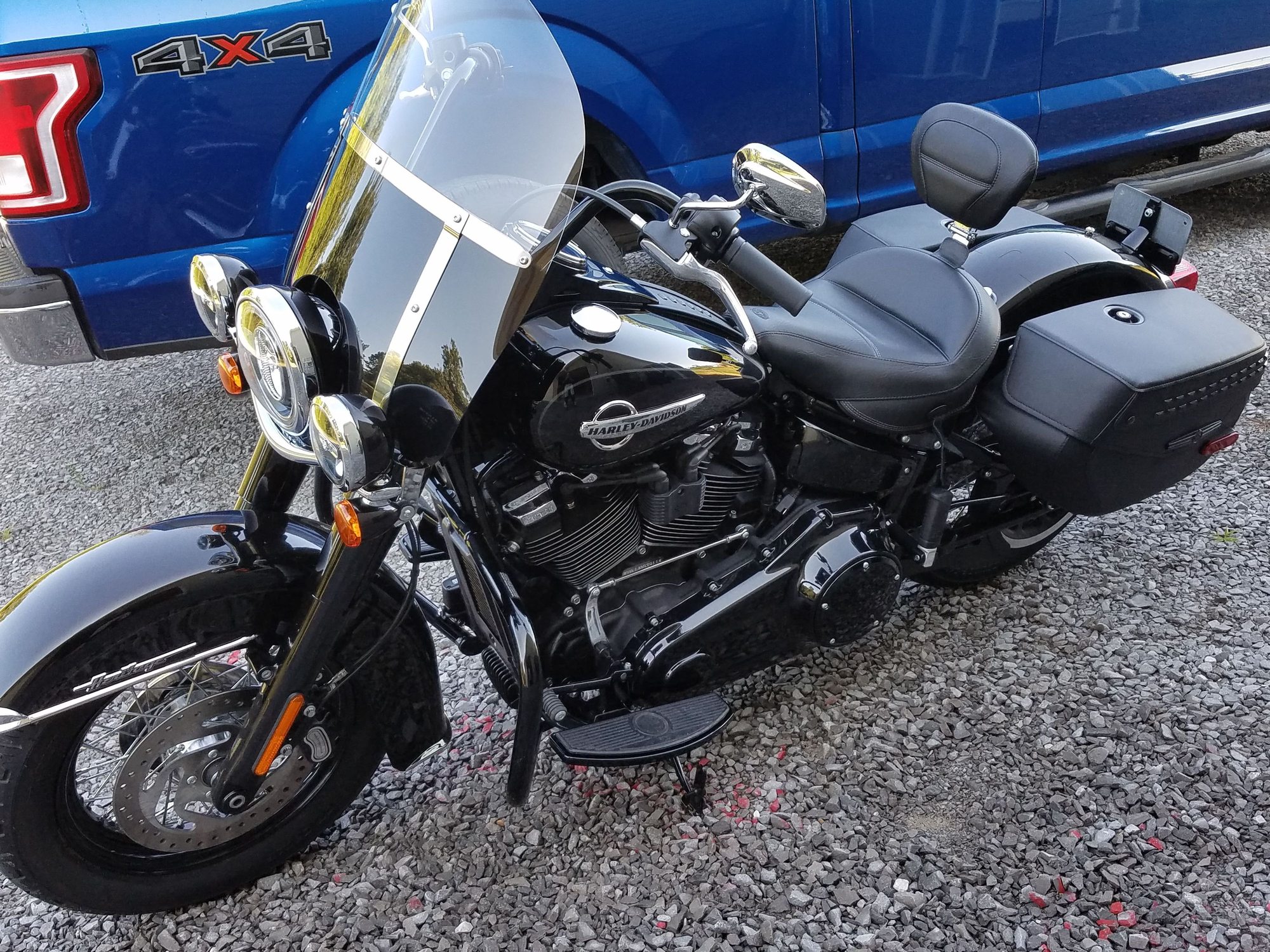

Latest on the Heritage.
I am not in need of any mods to the bars or risers. I have been riding with the Mustang seat and backrest and it is like riding in a Cadillac. That is an old expression meaning it is very comfortable. At this point the Mustang seat and backrest are the only mods.
Some new photos.

I put alot of time and miles on my bikes. I ride everywhere I go, all year round (except when road conditions are too dangerous, and even then sometimes)
I keep the strap on for a place to hook bungee cords when I need to.
There are times you can find me using my bike like a recliner, or even taking a nap, especially when out on a long ride or hanging around with other bikers.
Before the mods to the seat mount, it bent back enough to eliminate any support every time I accelerated.
The backrest is necessary for me to ride, the support removes pressure from a couple degenerated discs in my lower back, without positive and reliable support, I can't ride very long.
