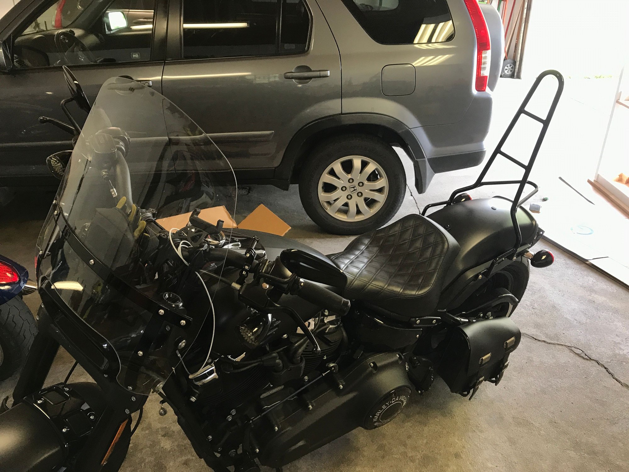

My Edward Richie sissy bar came in today. Looking forward to a Labor Day road trip. Sorry for the messy garage, woodworking project in progress.

Hey Bro...
could i ask which fairing you have. Im torn as to getting one...but i like the look of yours...not to much there.
