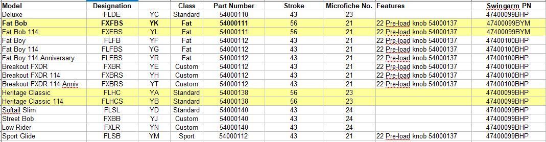

I just installed my FXFB Fat Boy shock. The Progressive shock that was installed is PN 465-1186, which is the "standard" 11.6 inch length and spring rate.
I had measured from the axle bolt to the chromed fender struts. The new "longer" Fat Boy shock only raised the rear end 2.5 mm. As in about 1/10". Maybe I should have left well enough alone!
At least I now have remote preload for when I carry a passenger.
FWIW, the installation proved to be quite easy, and that include the new bracket for the preload ****. Test ride to follow.

I installed an FXFB shock, which I thought was longer than the stock Low Rider shock, but when I measured the axle to fender struts, it only raised the bike about 1/10th inch over the Progressive 465-1186, which is the "standard" 11.6 inch length. Unfortunately, I didn't think to coimpare the length of the FXFB shock to the Progressive when they were both out of the bike.
Anyway, back from my test ride. Think I'll leave the new shock in. Don't have enough miles or pavement variation to compare the Fat Boy shock to the Progressive, but so far, so good.
Below is a table I made of all the shocks used in the 2018+ Softail lineup.
Now that I look at the table above, I'm wondering if it was actually a FLFB Fat Boy shock I got off of ebay. It was listed as a FXFB shock, but I never checked the part numbers.
Nice table, good reference.
Standard length of Softail shock is 12.6", so you didn't change anything as far as length.
