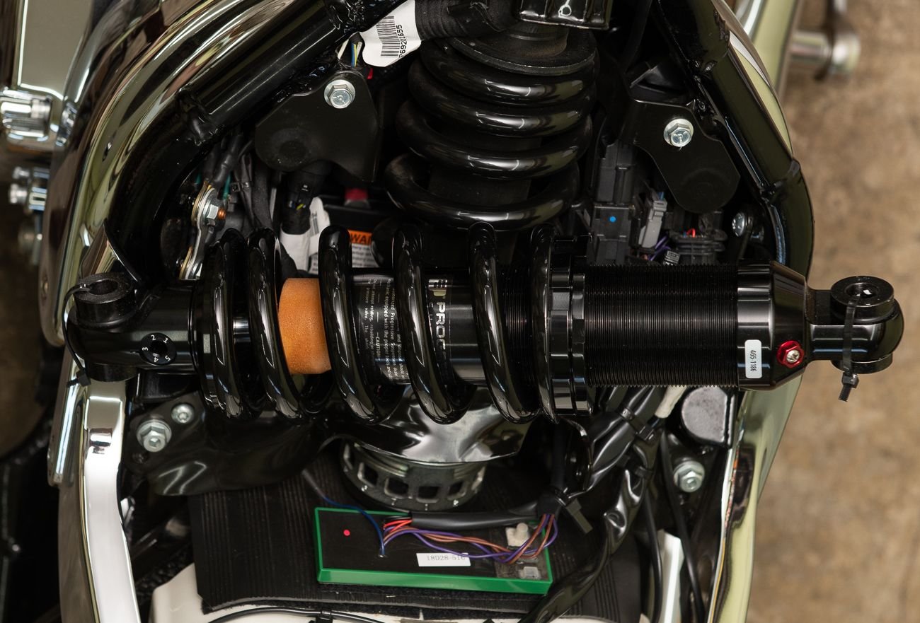

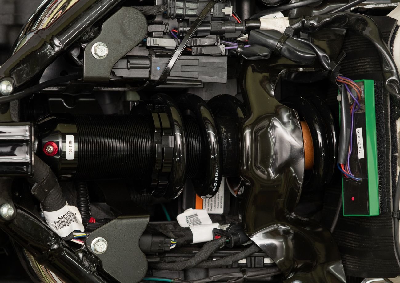

I'm average height and weight so usually I get an acceptable ride without changing shocks. My Low Rider (I think) rides better than my 2014 Street Glide did. The shock is adjusted to the lightest setting according to my weight. I thought the ride could be more compliant and the bike felt squirrelly at times, like the rear tire was leaving the road if I hit a bump while turning.
I've wanted to try a simple, relatively inexpensive shock so jumped into the 465. It's a real easy install, don't remove the rear fender and you can use their rebound adjustment allen wrench to loosen the pinch bolt at rear of shock. I just use a small, cheap screw platform lift to get the rear tire unloaded.
I'm not done playing with the adjustments, it will be easier to set sag with two people. The rebound adjuster has 5 clicks and is set to "3" from factory, I'm trying it at "2" right now. I've been out riding the city for a few days aiming for all the bumps I would usually avoid. The ride feels less harsh than stock and so far the rear tire has not left the road. I bought the stock Low Rider 12.6" length shock because I like the looks and feel of the stock height, so I'm expecting to hit that "surprise" bump that shocks the spine but so far I'm OK with the ride now. Oh, and for the weight weenies, I saved 3 pounds.
More opinion: I think this is crazy money to spend on a shock absorber cause I'd rather spend on going faster but making the bike more comfortable with different seat, bars and shock is all a part of the fun. I like the shock, I think it looks cool and gives me more ***** to turn. I'd say if you want more, spend more or change looks and feel with a longer shock.

Great writeup, Mike!
I haven't played with my shock at all because I just recently discovered it was installed on my bike. One thing I may do is increase the preload on the spring, since I'm hitting on the bump stop (the yellow-orange disc on the shaft) when riding two up, and that can be quite a jolt.
Looking forward as you experiment with yours and hope you keep reporting on it.

Thanks, my target ride sag is 1.2" if this helps you.

I haven't actually measured the sag on mine yet. Was about to order the Harley shock adjustment tools since I didn't get them with my bike (bought used), but then discovered that 465 Progressive shock under there. Glad I didn't buy the HD tools! But now need the wrench for the Progressive shock. (whoa is me. I got a $650 shock for free, but now I gotta plunk down $30 on the shock tool. Life can be so unfair! )
FWIW, I have Progressive fork springs and shocks on my '89 Sporty, and Progressive shocks on my '82 Suzuki GS1100E. Obviously I'm a fan. Sure, I'd like Ohlins, but the Progressives really do work well for the price. Improving suspension has big payoffs.
BTW, which wrench did you get with yours? The one that's hinged?

I used something like this in the past, just unload the shock makes it easy to turn:
