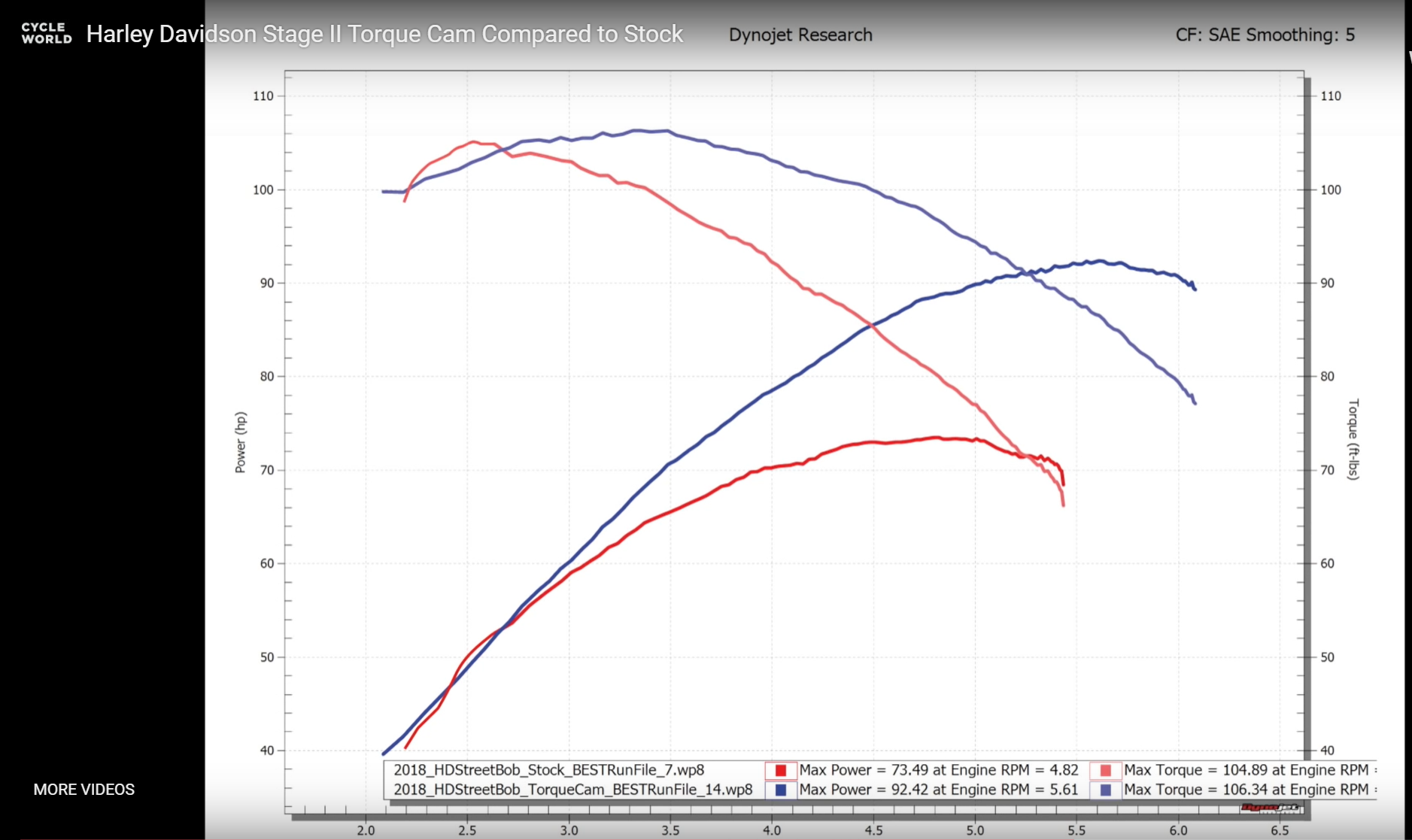

Old Apr 3, 2020 | 05:26 PM
Hulkss's Avatar
Hulkss
Joined: Sep 2013
Posts: 2,387
Likes: 2,380
From: Wisconsin
Torque cam on the CycleWorld dyno.
Old Apr 3, 2020 | 05:52 PM
FatBob2018's Avatar
FatBob2018
Joined: Nov 2017
Posts: 4,251
Likes: 3,134
Yep, that's what it does, and that's why so many of us like it. It's a fairly massive upgrade.
