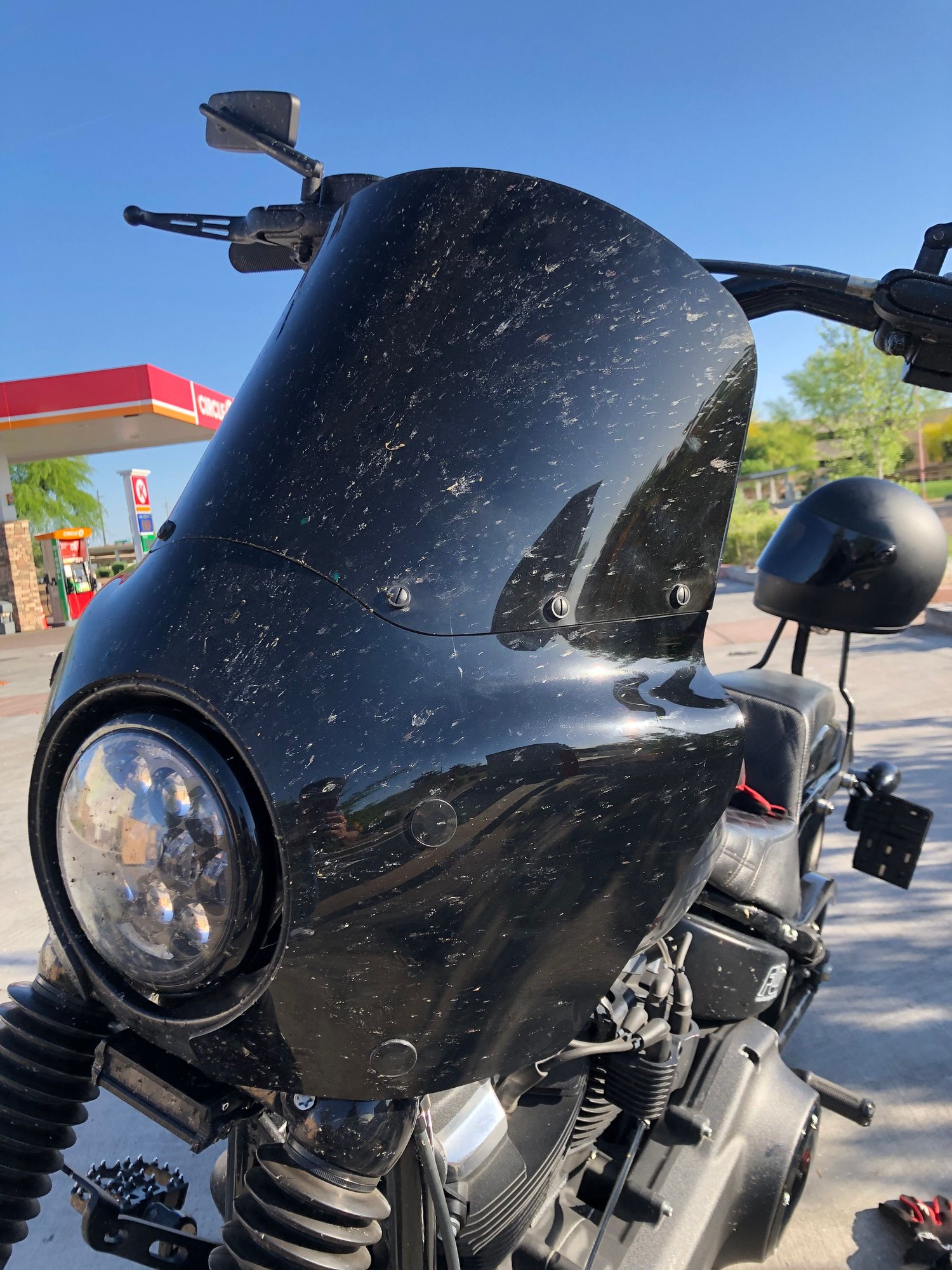

I also had horrible buffetting when I put the Road Warrior on my FXBB, it was so bad that I almost went with a different fairing. I tried every position possible with the clamp settings and after much trial and error - what finally worked for me was:
Getting the fairing as close to the bars as possible, I removed the extension headlight block and used the stock headlight setup. Then I reversed the clamps on the trees so they were pointing backwards and also adjusted the sliders as far back as possible. This did not stop the buffetting 100% but I'd say its 75% better, still have to tuck the front of my shirt in my jeans when going 60mph+ but it's worth it to me. I usually wear a helmet but when its 110+ degrees out I sometimes ride with a backwards hat and it doesn't fly off - it did before I reversed the clamps.
I tested with an 11", 13", and a 15" tall windshield and I feel there was less buffetting with the shorter shields. I run an 11" but sometimes use my 15" for longer trips and I definitely get more buffetting with the 15".
I also did a tank lift and that seemed to reduce it a little more.

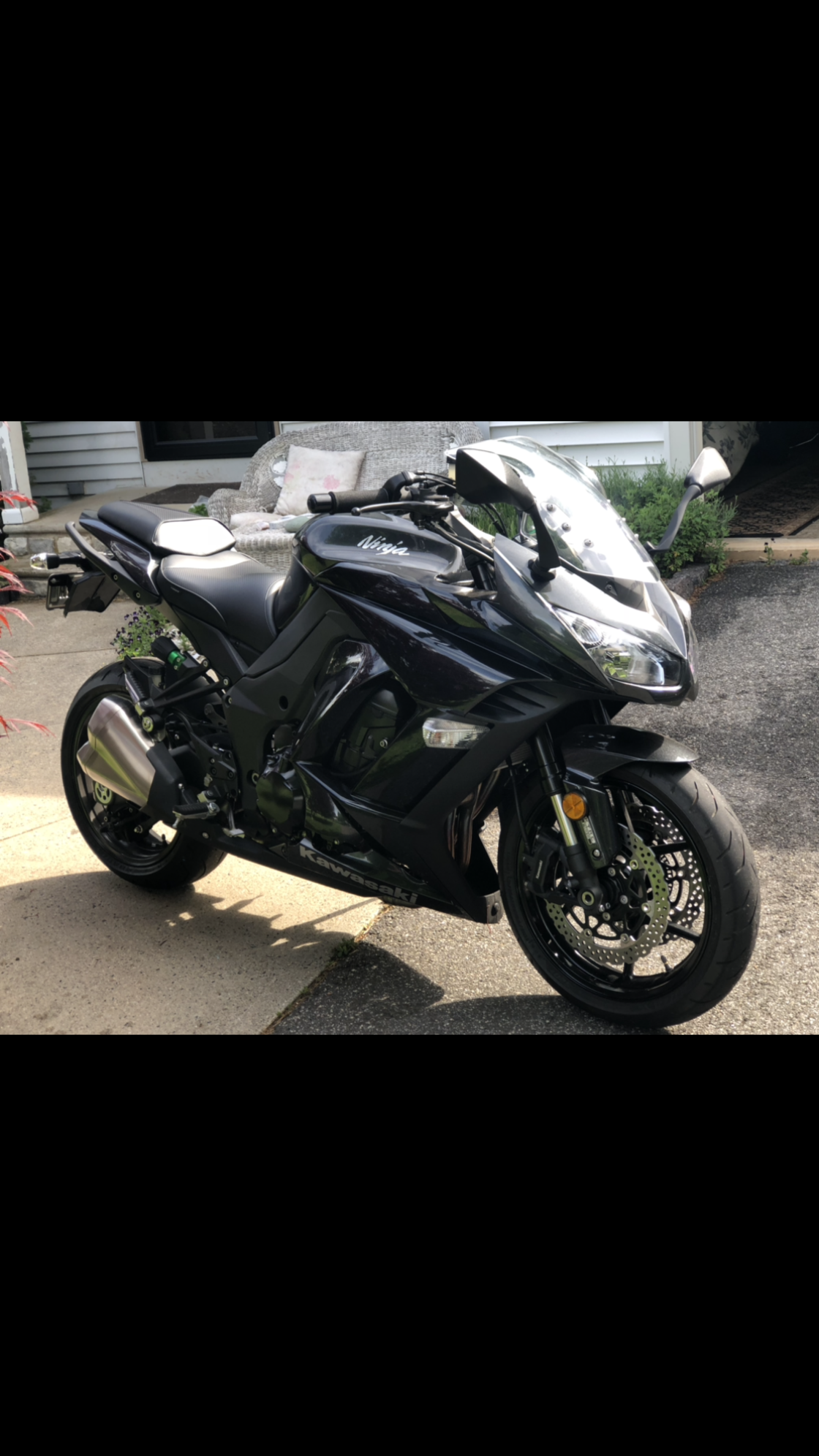

Kawasaki - stock windshield. No buffering with or with out helmet.

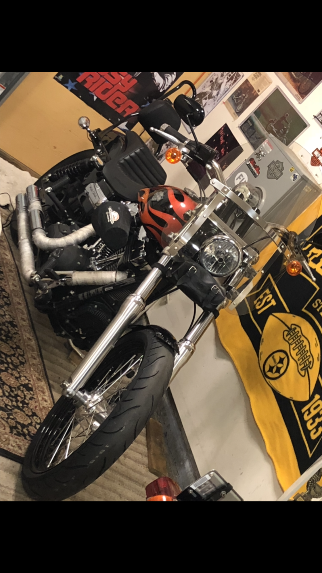

My wide glide with the shield cut down to nose level and tool bag almost zero buffering with or without helmet. Windshield tipped forward.

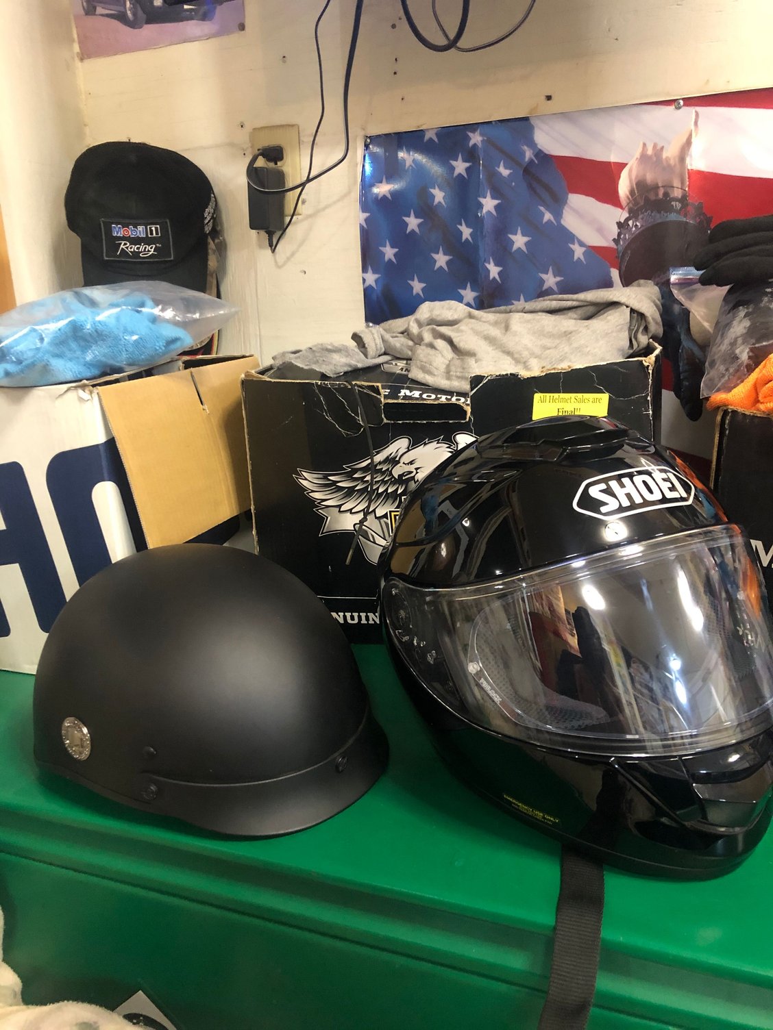

The Harley helmet sucks with or without windshield. The shoei is worth every penny!!

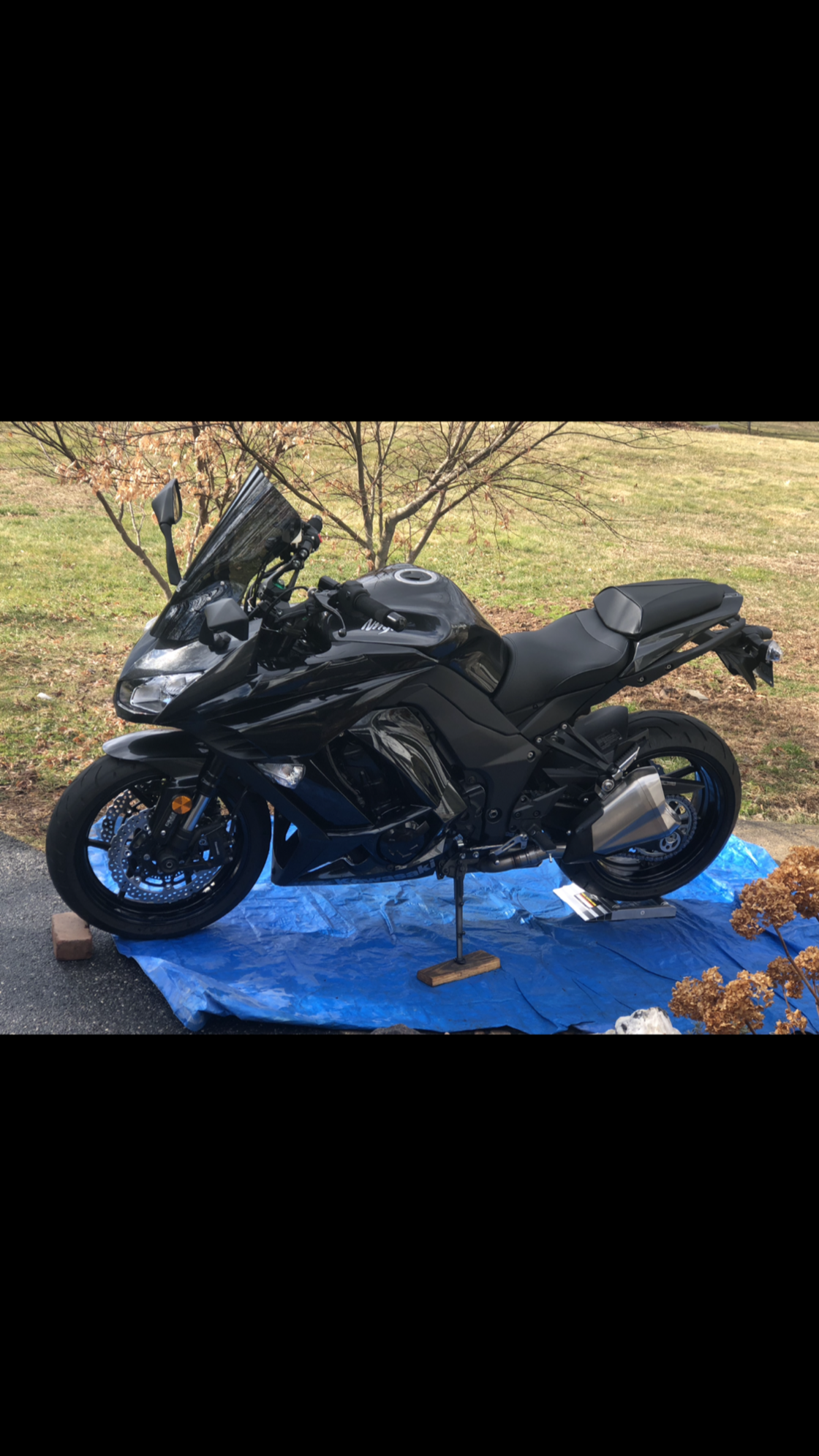

Kawasaki aftermarket windshield. No helmet a lot of buffering. With my shoei helmet was very comfortable. Best with windshield tipped back.
