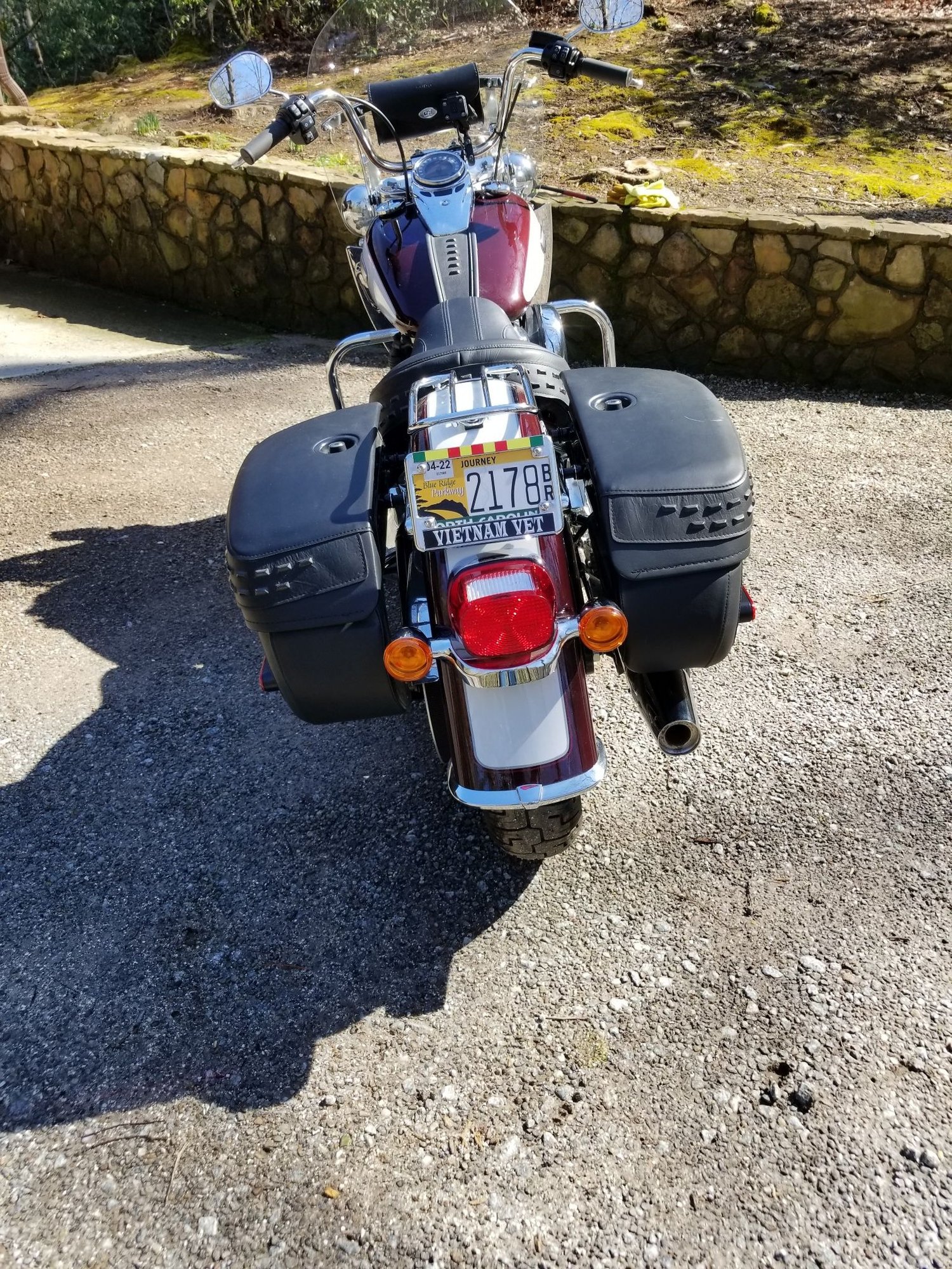

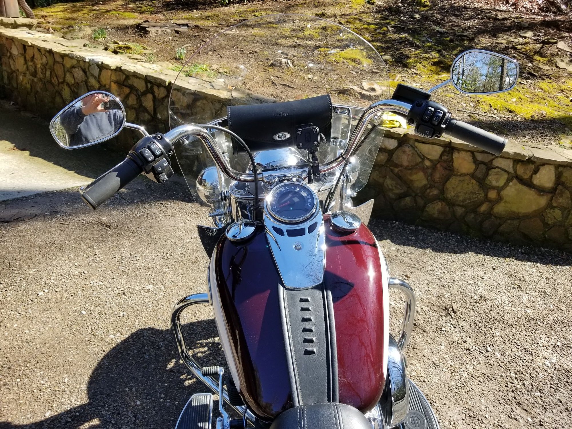

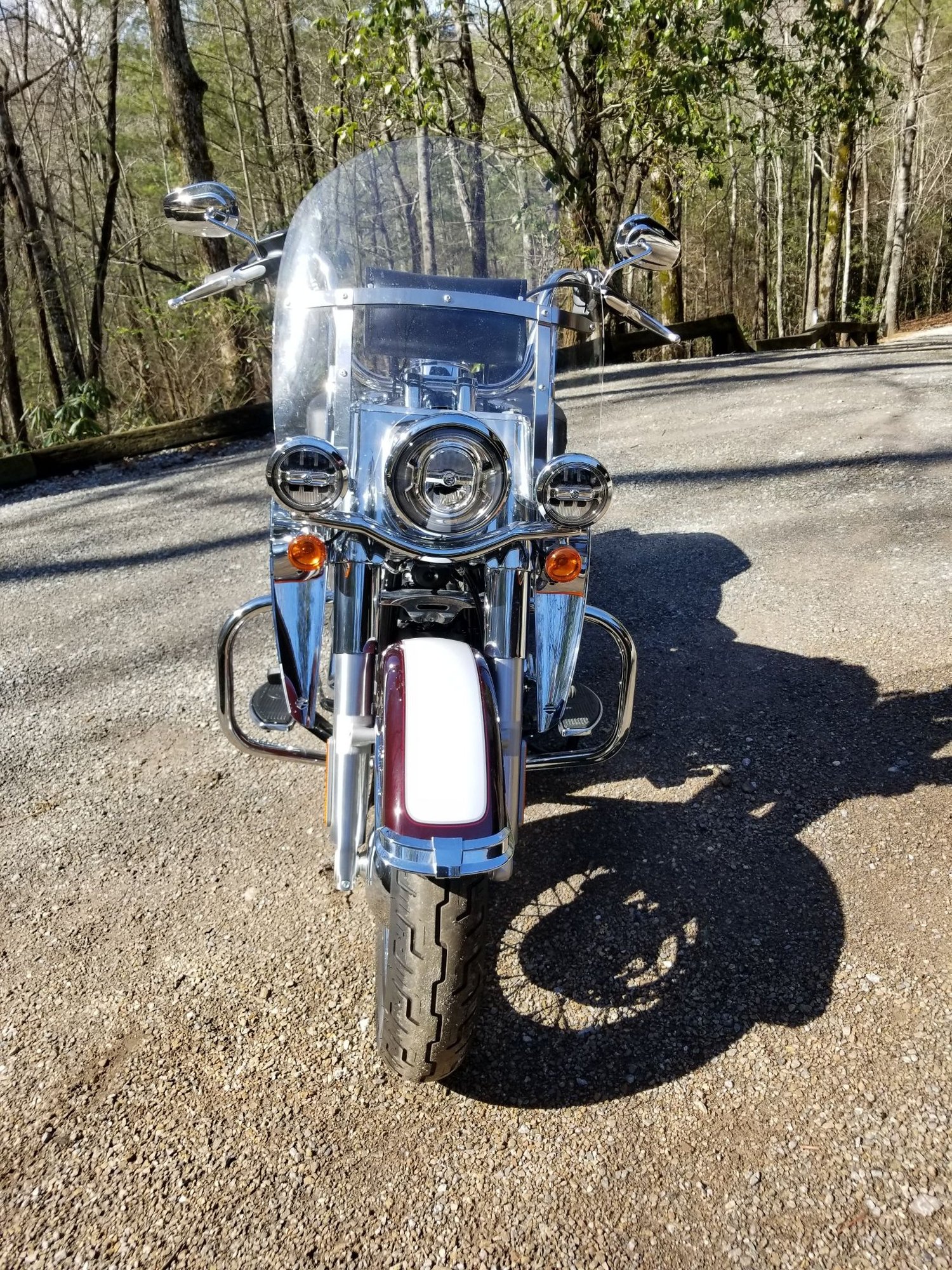

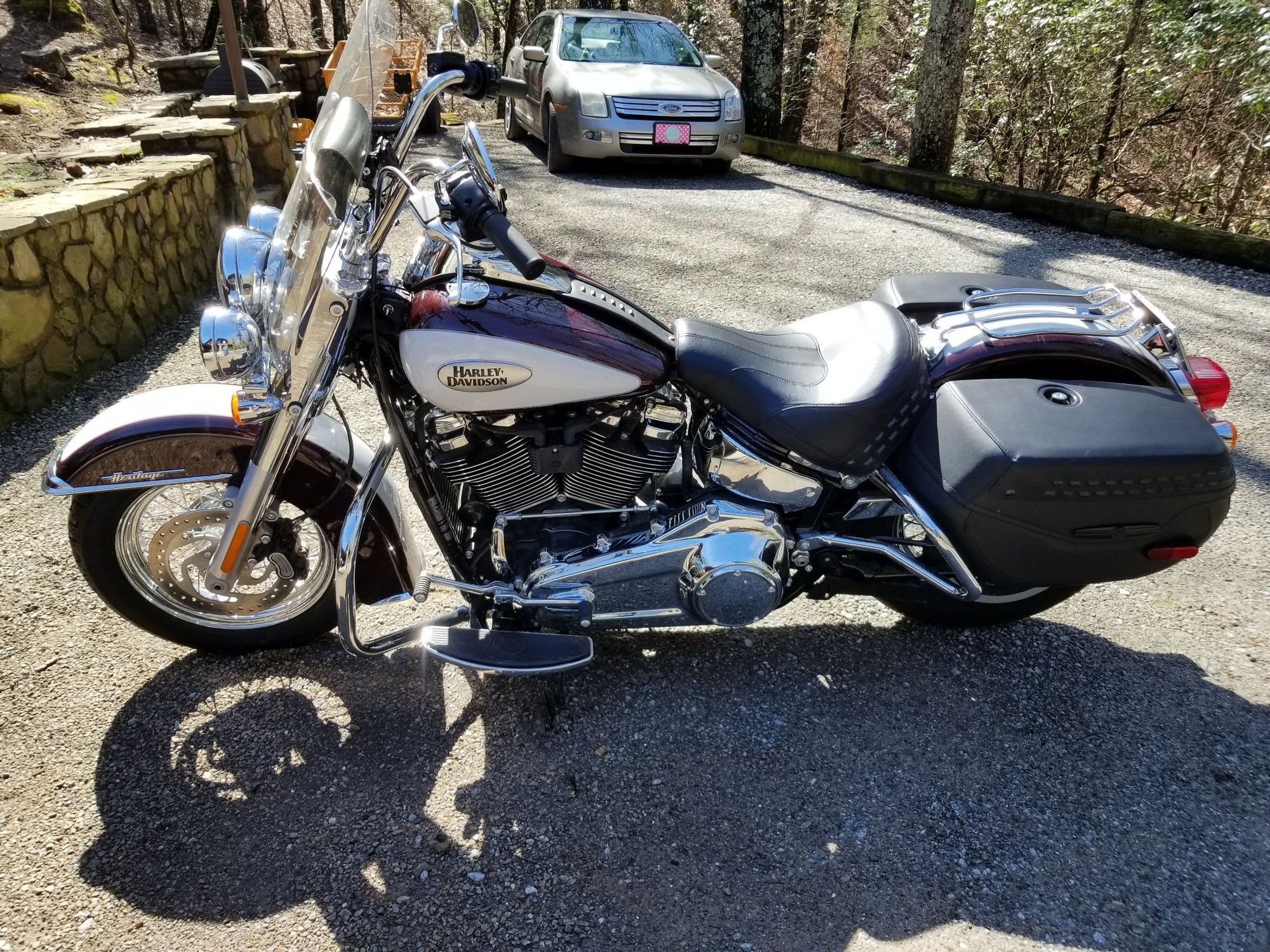

Added crash bars, bag bars, heel toe shifter, moved the floor boards out (DK Customs), Motherwell rack and, windshield bag and Zumo XT mount. I also installed some parts from Harley that are listed as non-fitting. I guess the term now is fangs, i.e.; air deflectors. Had to drill a new hole and mounted them behind the windshield quick release tabs. Lost the quick release option, but is not a problem for me. Also at full turn they barely touch the highway bars. They look good and work well. Harley's laydown license plate mount. Installed with no modification. I'm a fan of the old school tool box. Had to elongate the lower hole on the back plate. Used one top hole and the modified bottom hole. One the box itself, I used the existing top hole and
drilled a new hole in the bracket to level the box. Need to plug one hole in the box and I might drill a third hole if needed.

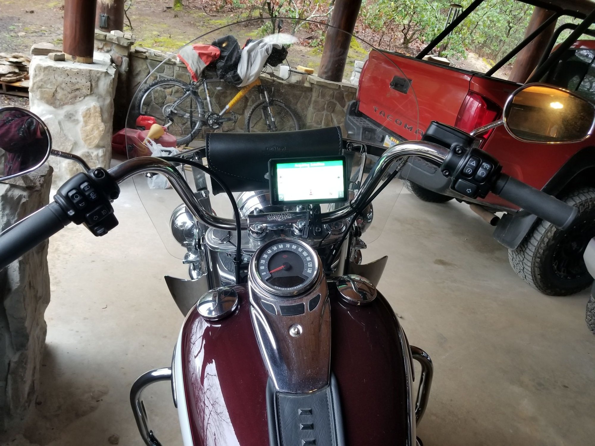

Can you post a picture of the Zumo XT mounted?

Here ya go.

I like it alll, looks great! I really like the tool box, does it come off easy to check the trany oil?

Good question and as this is a work in progress you've got me thinking of a modification. I'm going to take the tool box off of the mounting plate, two nuts and bolts easy to get at, then I'm going to drill the back plate to give tool access to the side cover screws.
