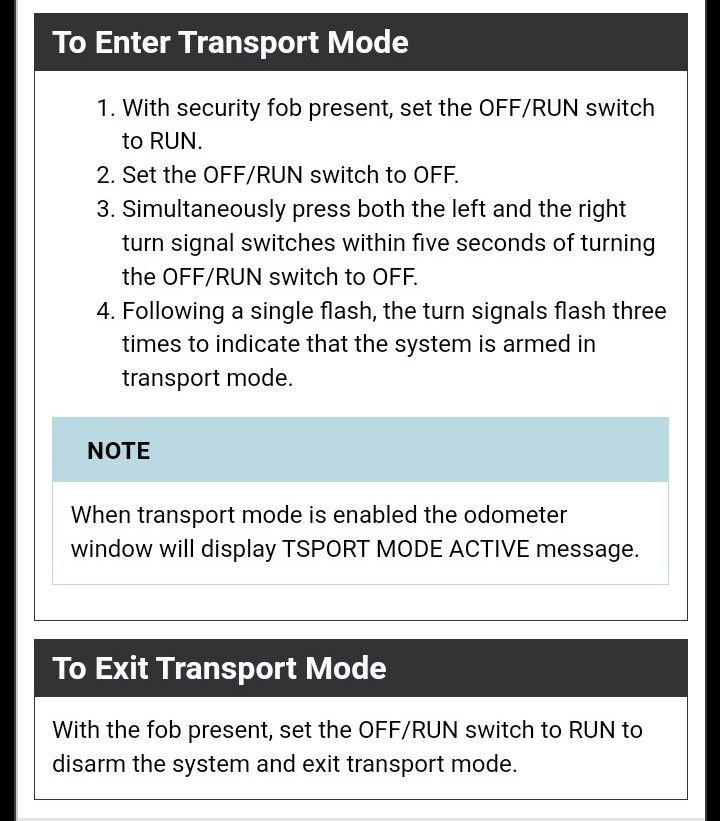

Apologies if this is a stupid question but can anyone tell me how to disable the immobiliser on my '22 LRS when the bike is being trailered?
I've got it over-wintering in a friend's workshop. I took it there on a trailer and as soon as it moved, the alarm system was triggered. I haven't got it on audible but the indicators were flashing all the way. Didn't matter as it was only a couple of miles up the road. But I'm moving house in the spring and it's a two and a half hour drive away. I've got two bikes to move so they'll be going on a trailer. I don't want to have the ignition on all the way there or have the the system flashing the lights the whole time.
My KTM doesn't do this. The immobiliser/alarm isn't triggered unless the wheels are turning, but the Harley goes off with any movement.

Look for transport mode.

Simply put:
ACTIVATE
1) Cycle the ignition switch ON and back OFF quickly
2) Hold both turn signal switches until the turn signals flash
DEACTIVATE
1) Turn the ignition switch ON

Magic. That's what I needed. Thanks.
