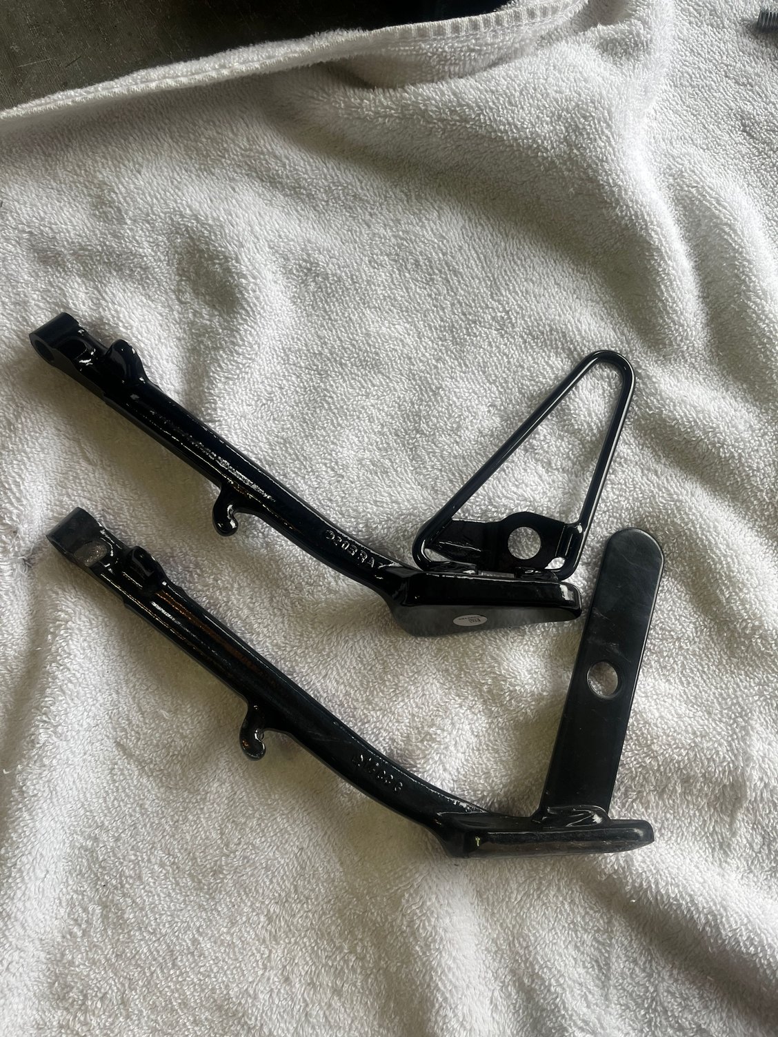

Kickstand leg for a Low Rider, HD part number 50000185
I didn't take any measurements, but the difference isn't significant. However, it is different enough that with the bike upright the foot of the kickstand no longer drags on the ground, eliminating the need to lay the bike way over to the right to fully deploy the kickstand. The bike leans over to the left a little more, but again not significant.
In the photo below I tried to lay one on top of the other in perfect alignment to show the difference. As you can see there isn't much, but enough.

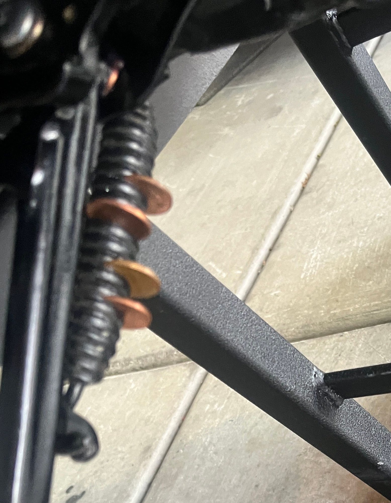

If you decide to do this, here's a tech tip for you. Put the kickstand down, then pull it out into the locked position. Jam a bunch of coins into the spring. This makes the spring removal/install much easier when the leg is in the parked position. Crappy picture, but you get the idea, and use more than shown here. Like 12 if you can.

Hard to say exactly, but it looks like the straight shaft on the Low Rider stand is about an 1” shorter?
