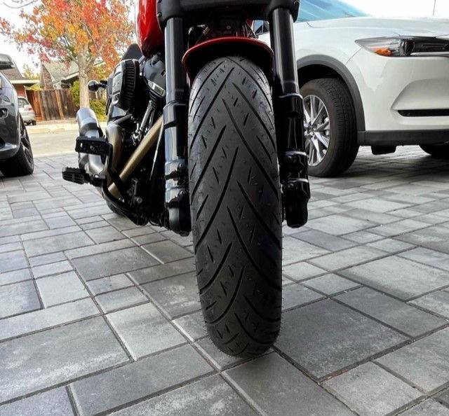

I went with the Metzler Cruistecs on my 2020 Fat Bob for just that reason. Plus I think they look better than the Cobras. The Cruistecs are night and day better than the stock tires. The bike feels more nimble and corners much better (or I feel more confident).
The Cruistecs have great reviews and I think the perfect tire for the Fat Bob especially if you are a single rider without loading it up with gear and luggage.

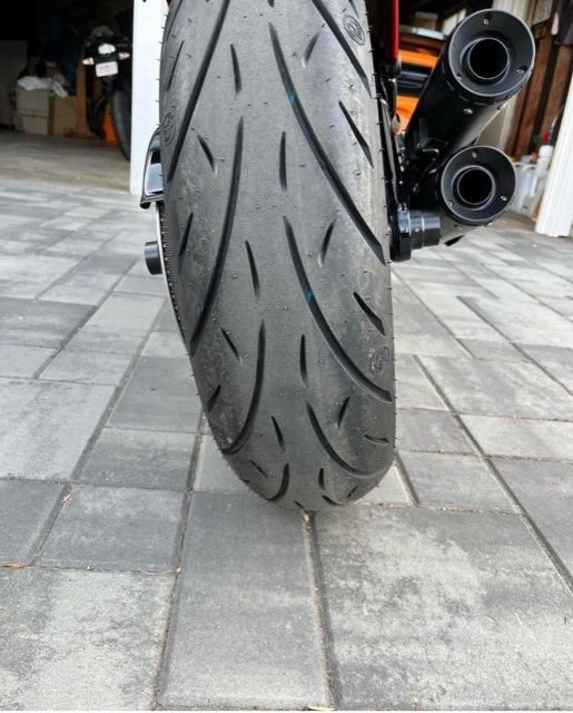

Both are stock dimensions, but now I’m not sure if the front is radial or bias. The rear tire for sure as it has a “B” in the tire size, but the front tire is this one.
150/80-16 M/C 71H
Metzeler Cruistec

Unless they specifically have an R in the number after the speed rating, they are bias ply tires.
150/80-16 = 150/80 B 16 = bias ply
150/80 R 16 = radial
