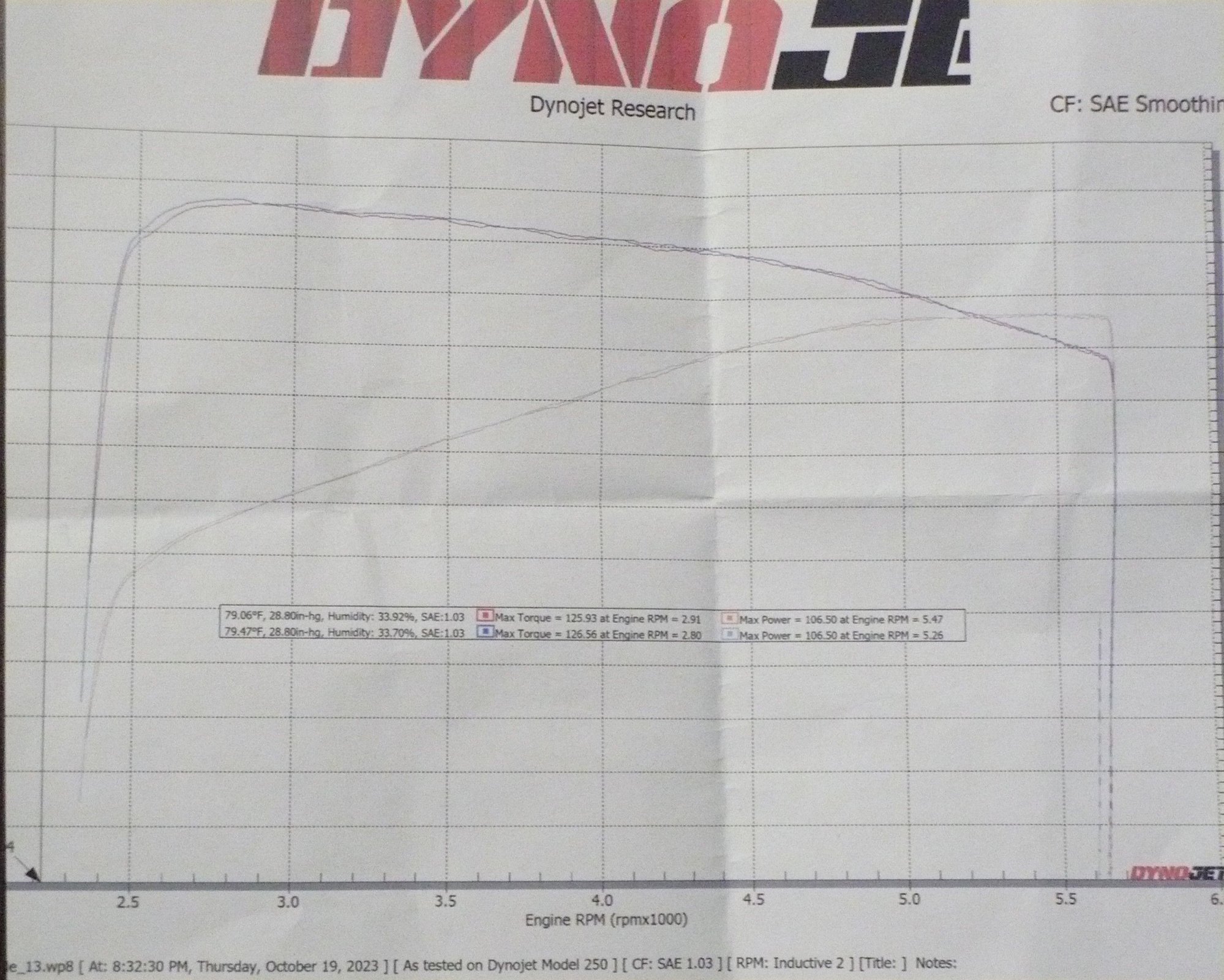

It is possible to have your cake and eat it too. You can get a good choppy sound at idle and have more torque down low than stock. Note, you may not have the most torque of all possible cams available, and you may not have the most chop at idle, but you can have more torque across the entire power band than stock, significantly more peak torque, more peak HP, a choppy sound and an all-around better running bike. It has been my experience, the bike will run cooler and if you ride it normal it will return normal fuel economy.
The key in all of this is to stay with bolt in cams unless raising compression etc., pick a good pipe without the cat and get a real non-epa tuner and tune. Fuel moto and other good aftermarket companies can absolutely help with the correct configuration.
I love the results of Woods cams but they have been known to have aggressive ramps and be very hard on the valve train. At least this was the case with the Twin Cam. I don’t know about the M8 but will consider Woods before making final decision.
