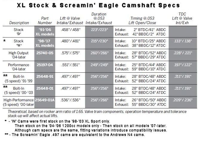

what year was your Sportster? Another thing the Sportster had over its big twin brethren besides cam specs is higher compression, at least the later rubber mounted EVOs. I believe they were running 10:1, which will add a little more ‘pop’ to the sound. The W cams were very good cams too and used in both the 883 and 1200s.
I found this chart…
I found this chart…
02, which I guess would be the D cam in your chart.
The same duration will be choppier in a smaller displacement engine as well.
Interestingly the D cam above has the same exhaust duration as the cam in my small block Chevy.
